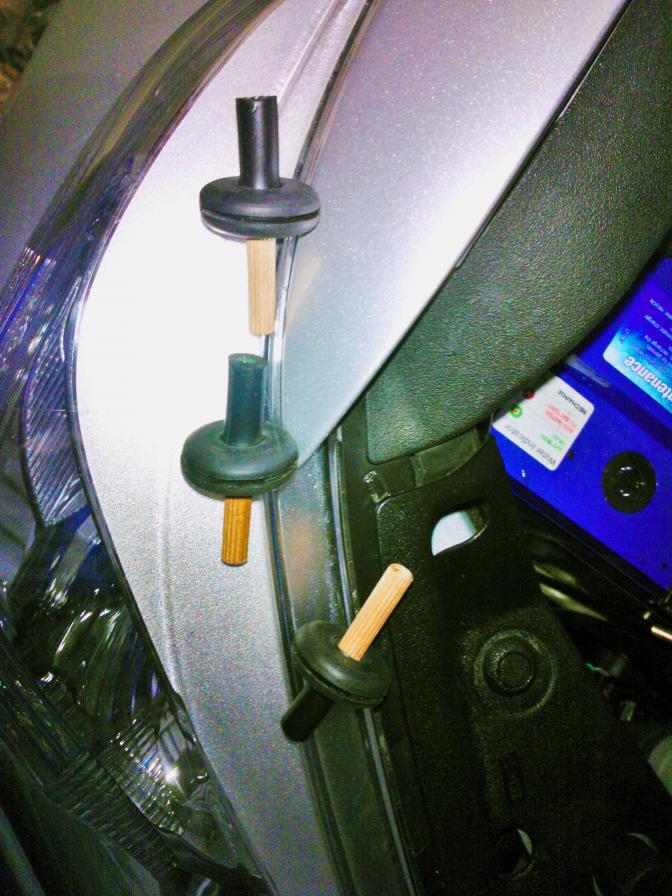

                              • Droning on...
                                Hi
                                Tried packing under the airbox and adjusting the bolts. No real improvement.
                                Made up three mounts to replace the three bolts that hold down the airbox.
                                The airbox still resonates but does not transfer most of the vibration to the car body.
                                Used a short length of rubber tube pushed partly over a plastic carpentry plug
                                then slid a rubber grommet to the midpoint.
                                The carpentry plug sits in the bolt hole and the rubber tube locates the airbox.
                                The grommet holds the airbox off the metal guard.
                                Much much better at 1,500 revs.
                                Will make up an all rubber mount next to replace the carpentrey plugs
                                which might be even quiter.
