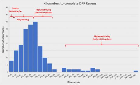

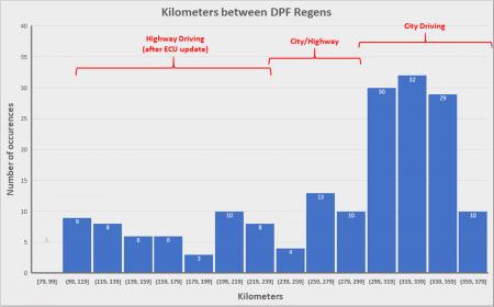

    DPF stats after 0-60,000Km on my 2018 GXL Prado:
    ECU firmware updated early 2019. Both Custom Modes enabled.
    Kerb Mass ex driver approx 2,700Kg.
    Accessories include GVM Upgrade, Bull-bar, Winch, Twin Wheel Carrier, Drawer System, UHF, Spot Lights, Dual Battery, Tools etc.
    Click image for larger version  Name:	Kms to Regen 0-60000.jpg Views:	0 Size:	16.5 KB ID:	752963
    Click image for larger version  Name:	Kms between Regen 0-60000.jpg Views:	0 Size:	15.5 KB ID:	752964
    Mileage Breakdown:
    a. ~22,000Kms open highway (100-110Kms/hr),.
    b. ~4,200Kms tracks, sand dunes, corrugations, mountains etc
    c. The rest city driving.
    DPF regens at highway speeds (post ECU update):
    Ave Kms to complete a regen = 30+Kms
    Ave Kms between regen = ~150Kms
    Regens often ended at 4% and some at 0%
    DPF regens for city driving:
    Kms to complete a full regen = less than 20Kms
    Kms between regens = 250-350Km
    Regens on remote tracks (5-10-20Kms/hr):
    Kms to complete a full regen = 2-5Kms
    Fuel economy scenarios:
    a . City driving = 8.5 Ltrs/100Km
    b . Highway driving (Wt ~3,050Kg max) = 12-13 Ltrs/100Km,
    c. On Dunlop AT20 265/65 R17 on Factory Alloy Rims = 8.5 Ltrs/100Km, city driving
    d. On Toyo AT II, 265/70 R17 Steel Rims = 9.7 Ltrs/100Km, city driving
    Notes:
    a. trips < 5-8Km won't produce the conditions for the DPF to start a burn. This is how long it takes to warm the system up before a regen will start/resume.
    b. 5 DPF burns during 5-10-20Km/hr grinding over sand dunes and remote tracks.
    c. 2019 ECU update significantly reduced the Kms between regens at highway speeds, and significantly reduced the time to complete a regen.
    d. DPF burn quits at 8% saturation, the residual heat energy carries the burn to 6%, and sometimes 4% or all the way to 0%.
    DPF Manual button has Custom Mode enabled. I can manually initiate a burn when the DPF level is over 28% before driving over dry grass. And it works!
    RPP

      Ahoy Grinbot,
      Pre ECU update it was taking 70-90Kms to do a burn at highway speeds. One time it took over 100Kms.
      My guess is that at highway speeds the DPF burn was struggling to keep ahead of the sooting-up process.
      Post ECU update it happens more often and therefor much faster.
