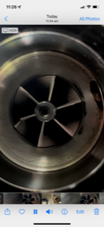

              so the turbo is rooted,
              as suggested here, the noise is likely a boost leak.
              so did the turbo fail and damage a hose or the cooler causing the leak or the other way around?
              i have been told that a leak can cause the turbo to overboost, and that can cause the turbo shaft to move and fins can touch the housing. either way i have to change the turbo and hope that the leak isnt the intercooler
                You can have a mechanic do a smoke test to see if there is any leaks. Will pinpoint them easily. (Engine needs to be all together obviously for this.)
                  replaced the turbo. noise is gone just like my dollars.
