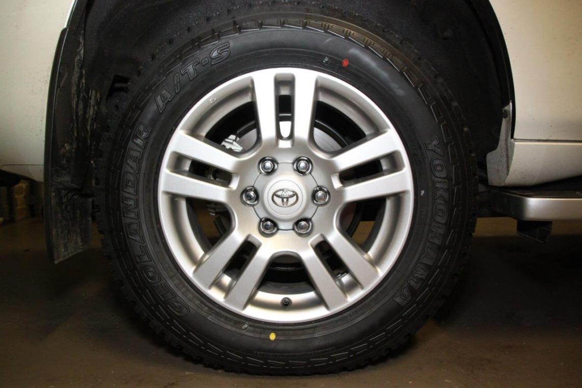

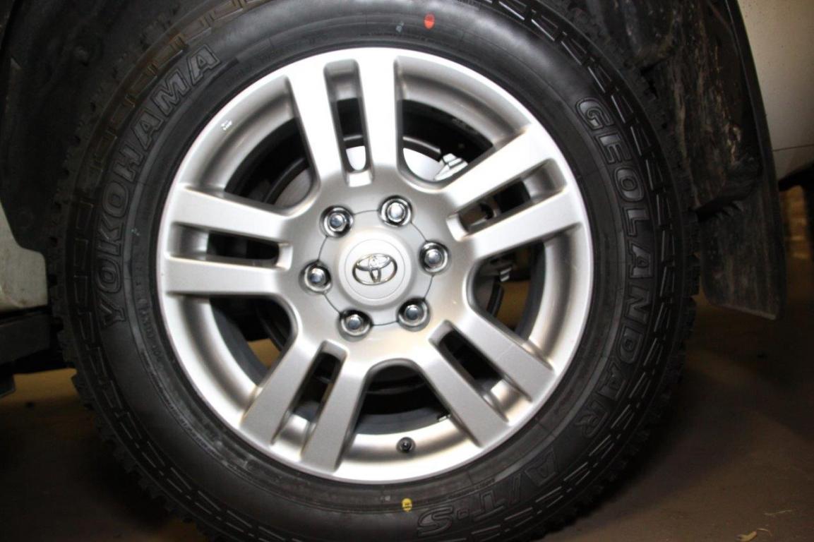

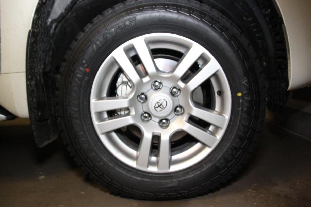

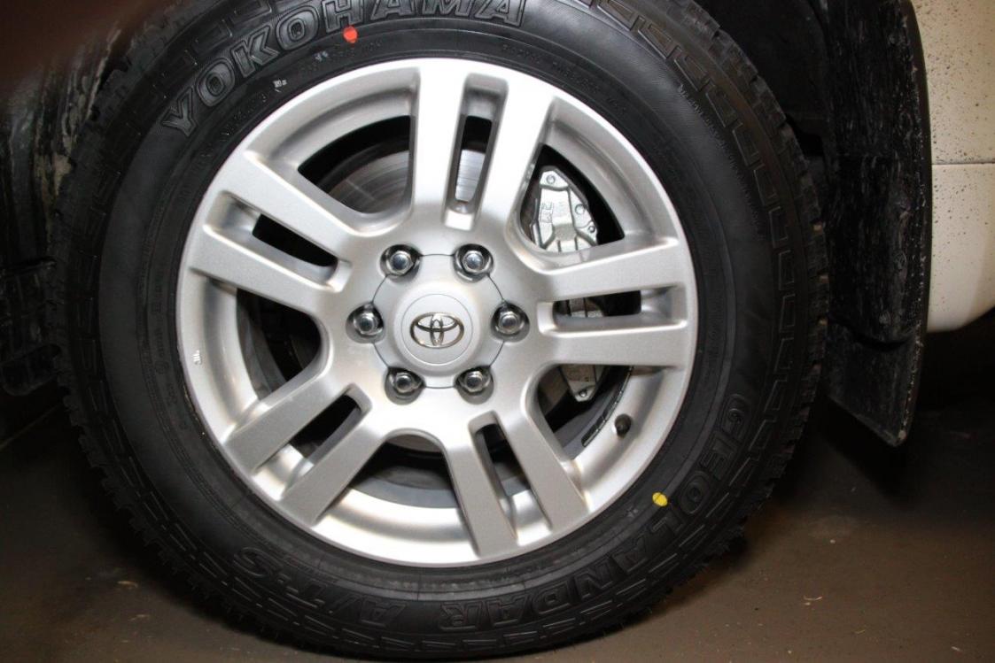

            Update - Problem Fixed - Defective Tyres were the cause!
            Hi everyone, thank you all for your help through this problem. I followed your advice and today BJ received the new Yokohama tyres and removed all tyres and weights from the rims. They checked the rims and they were all within 0 - maximum 15 grams out of balance. They said the rims were not the problem, infact the Kakadu rims were excellent.
            They started by fitting all tire yellow dots aligned with the valve stem and their match mounting machine only requested 1 tyre to be rotated on the rim a small amount. The wheels balanced well and quickly. All done in 45 minutes. Everyone said the balancing went as expected, not as previously experienced on the 4 prior attempts of up to 2 hours on 1 balance. We all expected the test drive to be a success, which it was.
            The synopsis:
            1. The Roadforce machine stated that 3 tyres were marginal not a pass - They should have been replaced after first balance failed.
            2. When the Roadforce machine was moving the yellow dots far away from the valve stem, the rim could have been checked and then the tyre could have been viewed as being suspect.
            3. Every tyre brand can have a defective tyre, regardless of history. 'There is a first time for everything'.
            4. As a post suggested in this thread, no amount of balancing will fix a defective tyre.
            5. Excellent advice received was to check the rims for balance first and if they are ok, then it must be either the tyres or balancing procedure. If the rims are ok, then either they replace the tyres or give a refund. This was very true.
            6. Stand with the tyre fitter and understand the process. The 5th tyre was only replaced because I asked if it had been done, they said it should be ok from yesterday, and I insisted it was replaced as it was from the previous batch. The tyre was supplied by Yokohama, so no additional cost to the tyre fitting company, except 10 minutes labour.
            7. Be persistent and ramp up your frustrations if you need to so that you are taken seriously.
            8. Consider the customers inconvenience when dealing with problems, they have better things to do with their time than to be revisiting the same issue 5 times.
            9. Thank you to BJ for following through, Yokohama for immediate agreement to supply new tyres free of charge without any issue.
            10. Thank you to Prado Point and all members who shared their input and gave me the direction not to refit the OEM tyres and pin point the issue must be the tyres. What a great Forum with great members
            I was worried about where the problem was coming from as I had not driven the original tyres on the freeway or at speed. I am now very relieved it was the new tyres and thank everyone for their advice. It really helped.
            Now a 2 hour one way drive north from Sydney to Newcastle on Saturday morning will be nice and smooth. Stockton beach and dune drive on Sunday and a return trip without vibrations will be the first time since new (2,300km) that we can drive at speed and enjoy a smooth new car. I now feel good about our 3 week young vehicle
            Photos of balanced tyres below for amts:
