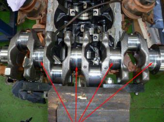

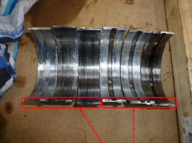

          Though you guys may want a look at the destruction....
          Still in limbo. Consumer Protection believe the most likely scenario is they started it up and idled it for a while with no oil, doesn't believe the damage is consistent with the card being driven to destruction (9km they did).
          But he doesn't believe the card has been submerged (and therefore Toyota's claim that it was a potential cause to premature failure).
          Though, it looks like whoever replaced the window before it was wholesales f*cked it up, as the car has been sitting outside a workshop for the past 6 or so weeks and has a decent amount of water under the carpets.
          Great.....
            They have started it up, got out of the vehicle and "checked for leaks" etc. As a result they wouldn't have seen the check oil light (not sure if the vehicle stops when it detects this. By the looks it doesn't) until they heard grinding noises or the engine stopped due to seizing. If they drove it they would have seen the oil light and damage would have been a lot more one would think.

                No denying that crank has been run without an oil supply. It stinks that they don't have the balls to stand up and be counted.
                  Yep, they are too busy trying to get out of it by saying the think the car has been submerged at some point and that its was pre-existing. That the oil change was the straw that broke the camels back. Think they are trying to say someone masked engine knock with a thick oil.

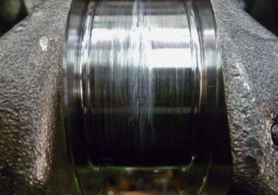

                  Consumer Protection guys has spoken to bearing and oil companies and both have said it is theoretically possible, but doubt I would have been able to do the 5000km I did without hearing anything.
                  A mate also said the lack of oil deposits or signs of oil burn tarnish on the crank or hot spots to show there was no oil present when it occurred, therefore that should save me from Toyota's masked noise theory.
