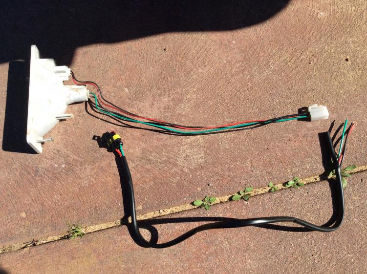

Originally posted by Bailey84 View PostWere the LEDs plug and play or did you have to cut and join the wires?
Just to make it easier.
So what I did was cut the original cable 100mm back from the connector, join the cables, you do just need to seal off 1 of the original earth wires, and then used the connector.
Took about 30 mins to do each side, including changing the fog light bulbs,
and adjusting that wiring also, once I had the wings off.
Looks good now, and I won't have to replace those damn bulbs again now.
