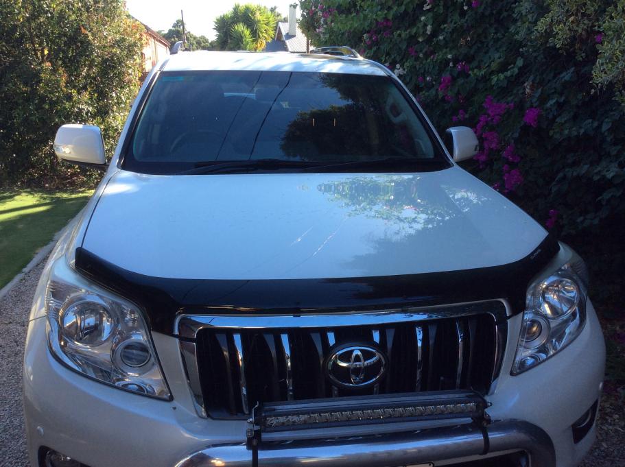

                          • Installed genuine Toyota bonnet protector. $88 from local dealer, cheaper than all the stuff on eBay.
                            Insect screens on order from ARB
