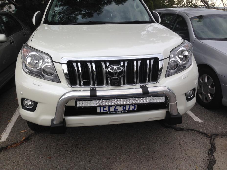

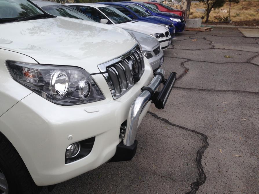

                Good news, after the events of Saturday night, I moved the light bar forward and slightly below the nudge bar and the radar/cruise control now works. As was stated above, the system was assuming the sensor was dirty?! and disabled the PCS /cruise control.
                I'm not particularly happy with the location as I can foresee swmbo managing to crunch it by parking too close to a wall.
                I'll try and put some photos up later.
                  If it is forward of the nudge bar, then it is probably illegal.

                    So the other option is hanging it upside down at the bottom of the nudge bar, but I suspect this would block the view from the camera too much.
                      Just a suggestion, don't even know if it's possible down your way, but what about a slim line number plate and mounting in in the bumper recess under the number plate? Don't know if it's possible, but I guess you would need to fabricate some sort of solid mounting to stop it vibrating around all crazy like. I think it would look mint hidden down there though, wouldn't be real easy to spot unless you were looking for it.
                      [LEFT]Silver 150 Facelift
                        ive seen them mounted in the lower intake in the bumper...pretty neat way of doing it.
                        FYI the radar is within the toyota emblem on the front...the 'cresting' camera is the black box underneath

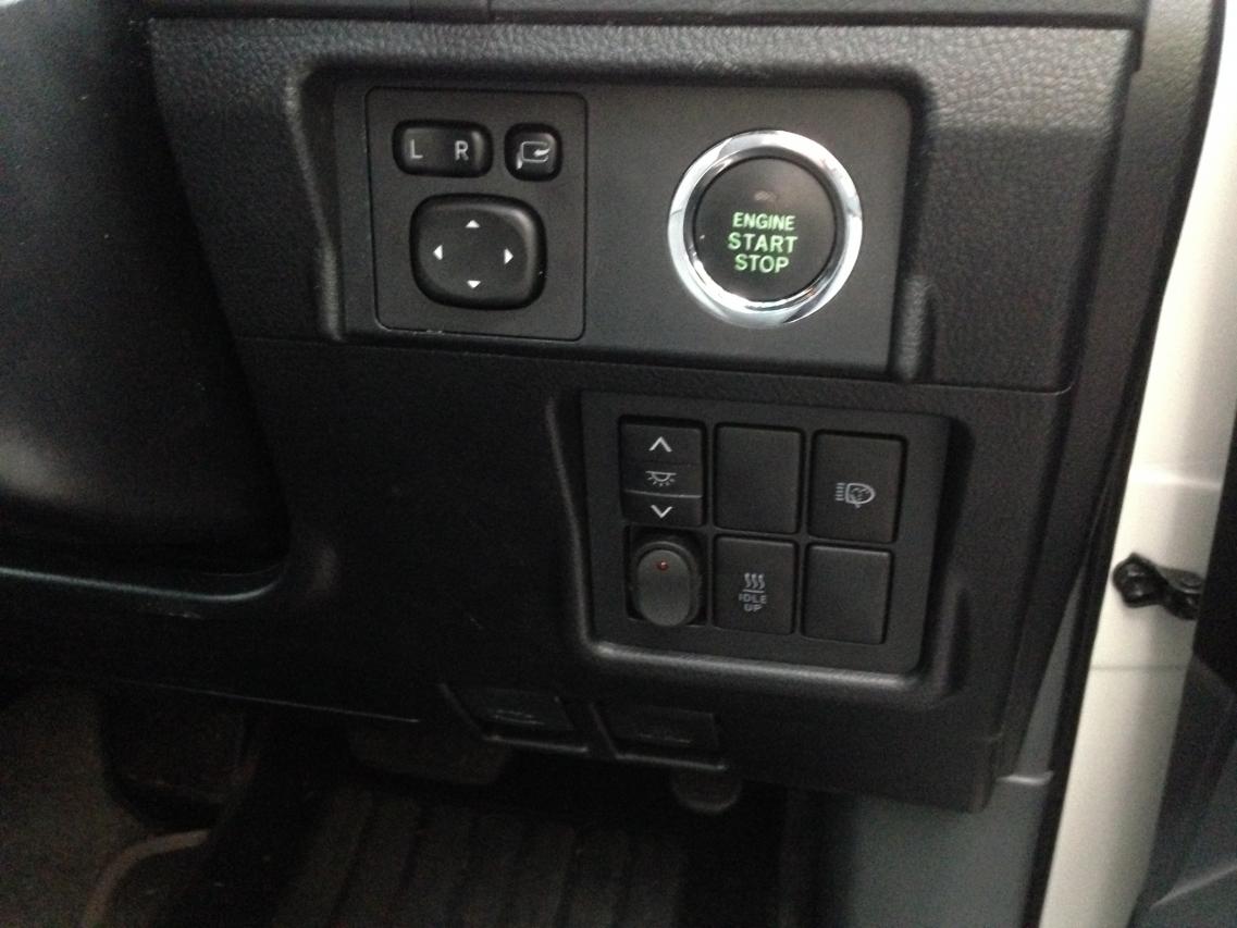

                        Also you can buy OE looking light bar switches on ebay so you can keep the factory prado look on the switch panel.
                        2013 (12 build) GX Auto.......with safari snorkel, toyota bar, tow bar, roof racks, led spots with fancy newpro switchgear, uniden remote UHF and aerial, ARB bash plates, Roadsafe recovery points, digoptions radio, general grabber AT2s, cheap ebay roof rack that has stood up surprisingly well.....
                          But wouldn't mounting it in the lower intake result in reduced airflow to the radiator? I know on some cars the lower intake is actually the main air intake for the Radiator and in Perth, air flow can be really important especially on those 40 degree days. i agree I think it would look much neater. I am also considering turning the light bar over (because of the way the brackets attach) and mounting it more under the nudge bar but i may get in trouble with the plods for blocking the number plate
