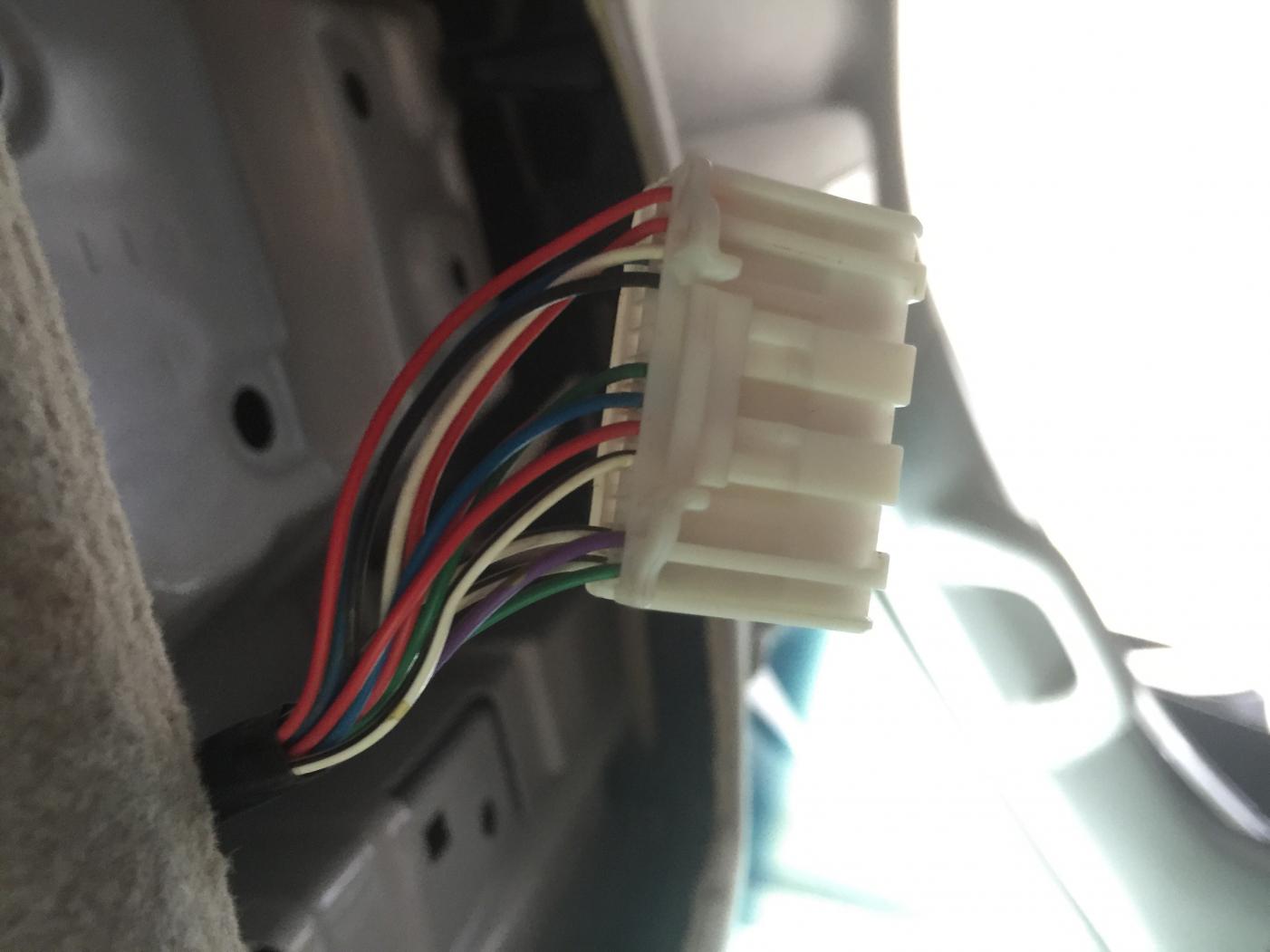

        Thank you! Now I'm having trouble figuring out which cable is power so I can run my rear view vision reverse camera (wireless) I had it connected to the map light directly but the screen would only work when the map light was on. So I want to now tap into the cable directly but have no idea which colour cable that power is on. I've done heaps of searches and can't find any diagrams. Here's a photo
          Hope the photo works

            I can't help you on that one as i own a 120 series & not 150 series so don't have a wiring diagram!!!
            The simplest way out (If not savvy with a multimeter) is to get a test light & put the crock clip end to a good earth then poke around (All doors closed) and test each wire for a power supply.
            An ignition live would be the smarter choice! (Will switch off when ignition off).
            TIP! .. Rather than forcing a test light or multimeter prong into socket plug (Is small needle tips) use a sewing needle to penetrate the wire then put test light onto the needle.
            Here is some >>> test-lights<<< for an idea on prices if you don't own one but a local car accessory shop is your quickest option!

              Thank you mate! I've got one & found the power source but for some reason it wasn't enough to power the monitor but when I plugged it into the globe holder part it powered on. So the wires before the loom was not enough power but the power on the board after the loom would work. I'm given up....Appreciate your response a lot!! Cheers
