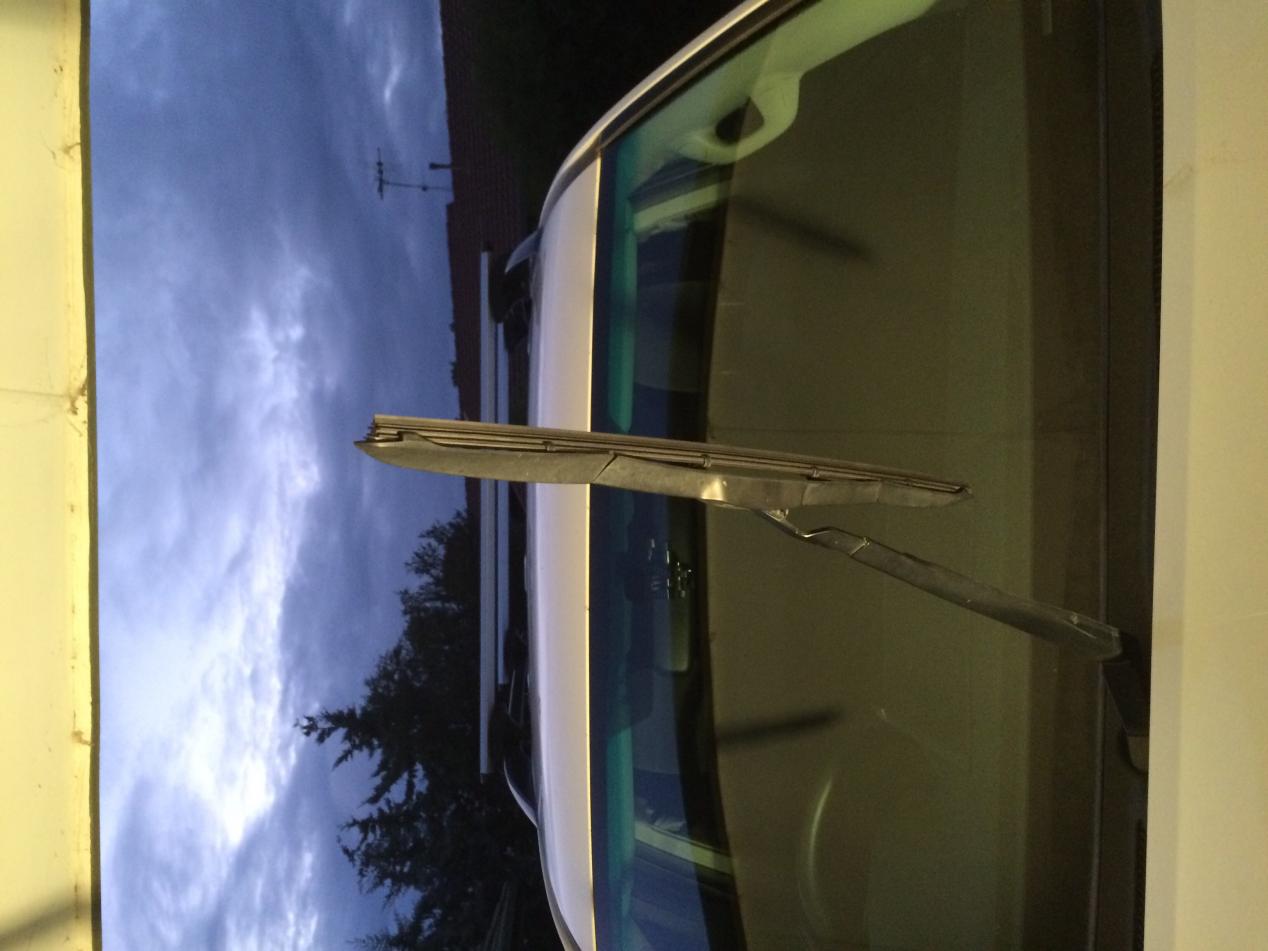

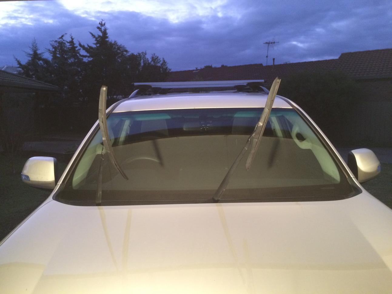

                  Had a look tonight and all I can tell is that the passenger blade is straight and the driver one is curved
                  Everything else looks normal. It seems like the blade isn't being pulled in in the middle.

                      Your OEM passenger blade has a curve to it. It's subtle but I reckon I can see it.
                      Does that mean mine's all kinds of useless now??

                            Definitely looks like a defective blade insert was installed. It should have a slight curve/bend and not stay straight!
                              I fixed it. Well enough for tonight anyway.
                              The metal bits were removable so I clamped them into a bit of a curve and heated them with a blow torch and created a curve.
                              It's not quite enough, but definitely an improvement.
