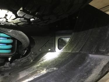

    So I had an ARB bullbar fitted a couple of months ago. Not only did they get the colour wrong (apparently the 040 white tints have changed in the lastest model), but they made a bit of a mess of the inner guards. One is cut slightly short and they haven't been fastened into the bar wing fender sections well and flap around.
    It also looks to me like there is a plastic guard missing per the photo. For those that have ARB bars on their 150 is this the same as yours? This is the passenger side whereas the other side doesn't have the gap...Click image for larger version

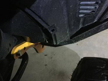

    Secondly, this photo shows where they have cut the other side short. Am I being too picky if I ask them to fix it? Click image for larger version

    I had my bar fitted on Wednesday, and when I got home I had a good look at it and thought the same about the passenger side, however mine is the same as yours. As for the drivers side I wouldn't be happy with the way they have cut the splash guard. You pay a premium price for Arb gear and for their installers to fit it and in return you expect it to be finished accordingly. I would take it back and have them fix it with a new splash guard.

      My inner guards were cut to a suitable length and tek screwed to the wings, not the neatest trimming effort but at least they were long enough!
      Here's two pics of the underside of my wheel arches to see how it compares with yours.

            I would be taking it further, that is crap workmanship.
