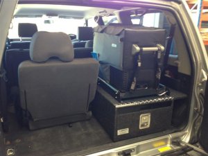

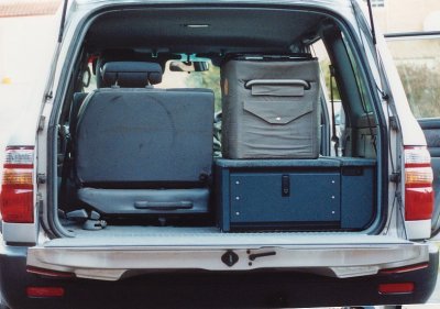

          A couple from the web
          http://www.tanami4wd.com.au/ModelRange.htm

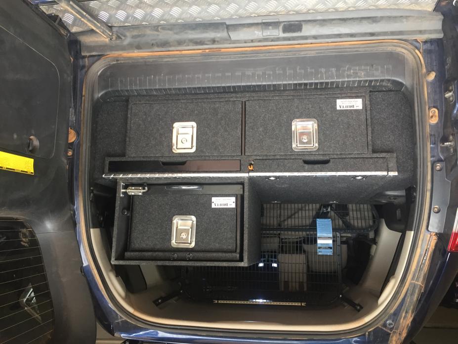

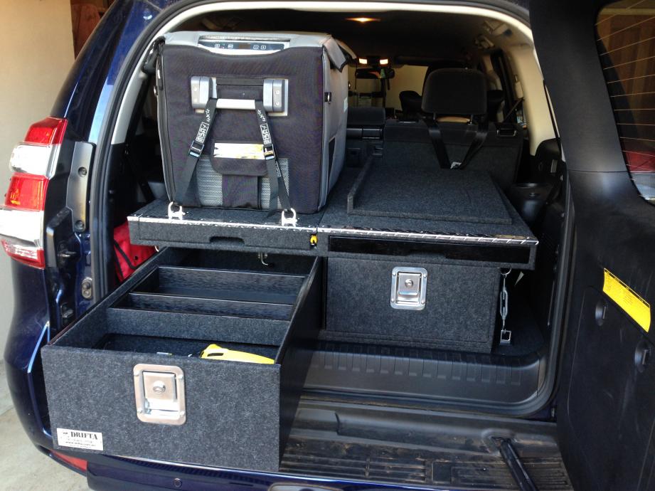

              Hey @antd I run a Drifta two drawer system & SD-DCB for the Prado 150 which is their removable version and mounts via the tie down buckles. I have three kids and when we are not going on a trip I remove the lot and allows us to have full access to all three rows. I have made the system fully portable so I can remove each part and put it back in when required. Of course it does take about 30mins to put it in or take it out but allows the best of both worlds and still make it look like a permanent solution when installed.
              I know it's not the single drawer you are after but as you can take it out it might meet your requirements?
              Sorry pics upside down
              Have added another pic of the drawers without the side panels etc I made and you can see the tie down buckles etc

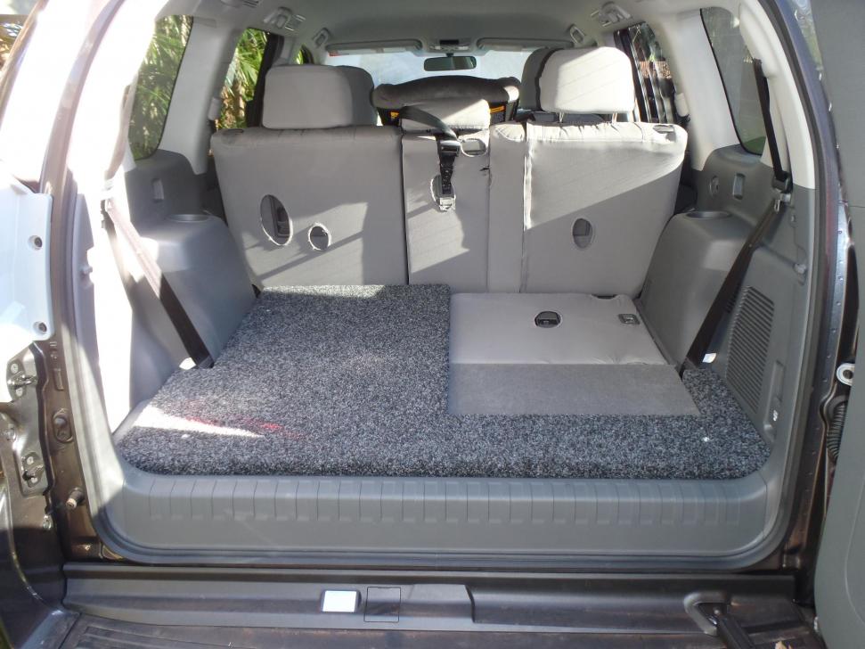

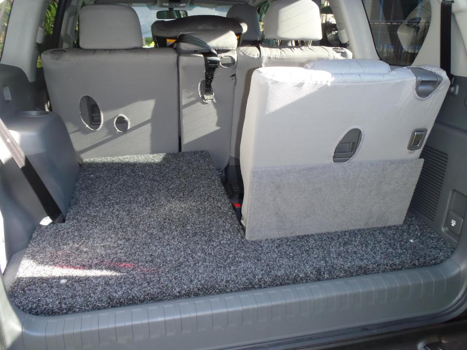

                  I found these examples via google image search on Pradopoint... this could definitely solve the how to mount issue.
                  http://www.pradopoint.com.au/attachm...3&d=1365944921
                  http://www.pradopoint.com.au/attachm...2&d=1365944871
