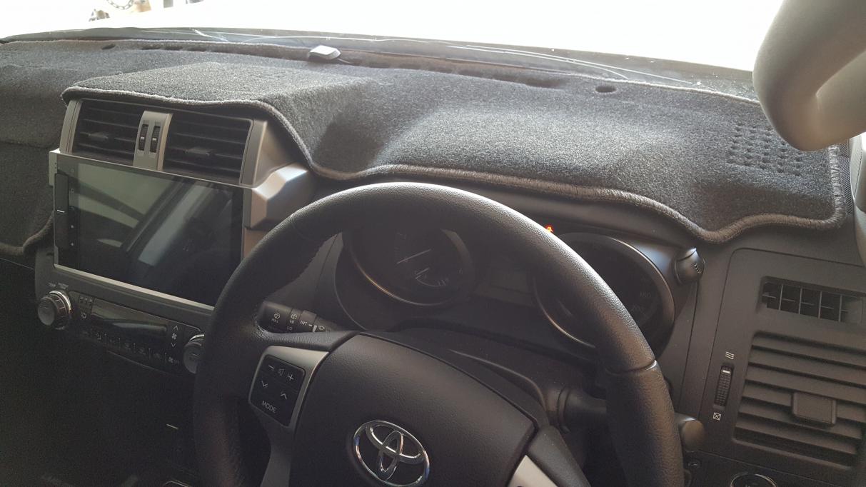

      Sorry I should have made it clear that the GPS antenna and mic do work OK, I ended up with the GPS above the dashmat which is a bit amateurish but gets a better signal there. The mic is stuck on the side of the speedo at present and the phone works, people can hear me OK. I decided not to take out any door pillar trim or alter any factory wiring at least for now so have taken the simplest if not the prettiest option.
      Here Click image for larger version
ID:	656392 is a picture of the mic and GPS.
