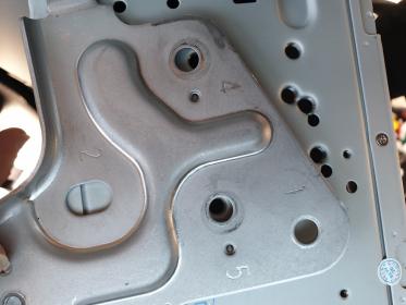

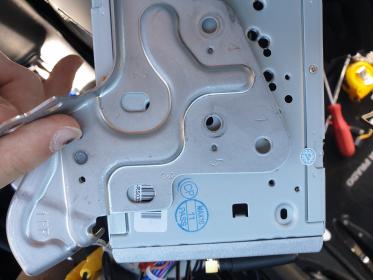

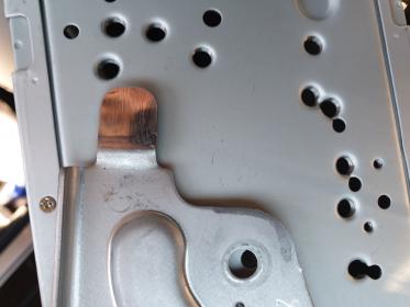

    Not so straight forward beyond that, sadly
    • #92
      Sorry to hear it didn’t work out quite as planned Very frustrating to read that everything works great except the brackets to hold it into the dash properly!
      It’s kind of the one thing that you really need to work properly.
