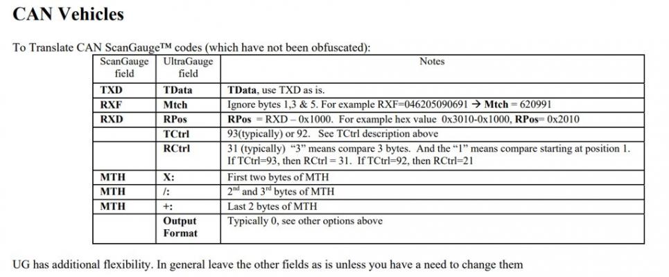

    I know this post is a bit long in the tooth but incase someone is searching for the answer.
    This post Scangauge II (SG2) Injector Feedback Values (1KD-FTV) - FOUND - Toyota Prado How To's, Technical Information & Reviews (pradopoint.com.au) has the injector x-gauge codes for the 1KD that can be converted to Ultragauge using the ultragauge blue or the table below for the MX1.4 (extracted from the programming guide)
    The Intake Air and Intake Air (Turbo) should be standard OBDII gauges so x-gauge if supported by vehicle looks like:
    ITEM TXD RXF RXD MTH NAME Unit REMARKS
    Ambient Temperature 07DF0146 044105460000 2808 00010001FFD8 AIR °C Std PID Hex 46
    Charge Air Cooler Temperature 07DF0177 044105770000 3008 00010001FFD8 CAC °C Std PID Hex 77 - Post Intercooler Temperature
    Note: The Obfuscated mentioned below is the term used when Scangauge deliberately offsets the published TXD code so it cannot be used on other devices (in this case the RXF will generally start with a C so the Scangauge knows how to correct for the offset).
