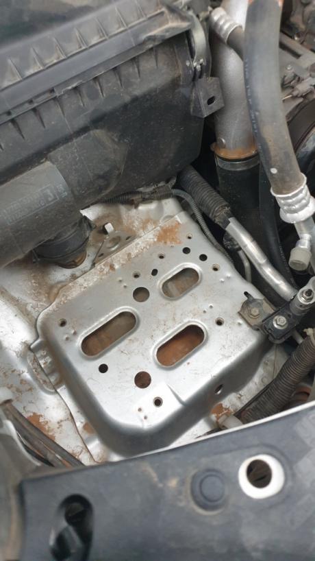

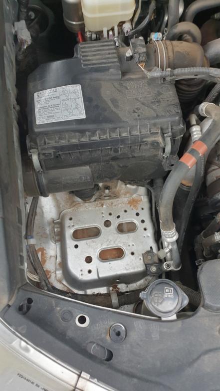

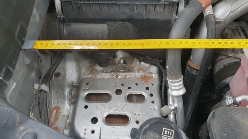

Hi, I am determined to fit a LiFePO4 lithium battery as a accessories power supply and basic dual battery system in a 150 2015 3L Prado GXL. The air con piping seems to interfere with the area designated on the driver side of the engine compartment. The battery is 306mm long and simply does not fit. Has anyone had this problem and was able to fix it, work around it or come up with great solution. Even thought of putting it in the back somewhere but nothing stands out as a well disguised place or that doesn't restrict loading the back with gear. Any ideas would be welcome.
Prado 150 2015 limited space for aux battery
I too have been looking but most I have seen are 330 mm long. In the 2.8 motor the 300 ish mm ones fit fine as the AC pipes are in a different place to the old motor but the 330 are within a mm or 2 of various pipes. My current old deep cycle is about 300 and fits fine on the TJM tray I have and am not about to change. If I could get a lithium at that length I may go that way as there would be cooling space to the pipes.
