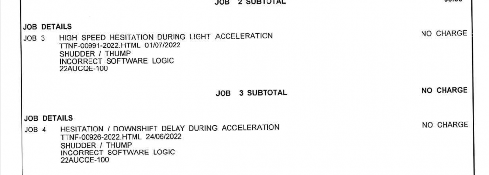

                      hi mate, this is what they put on my service receipt when they updated my ecu software, what is on your ? did you get both updates or something different ?
                      cheers, Simon
                        I I had my 1 year service Dec last year and mention these to the local service dealer - They insist the services bulletins are for the old 1KD - even wrote it on the invoice, and a different service manager assure me that it is a legal document and they dont lie and I shouldnt believe everything I read on the internet. Had me almost half convinced - I was too tired to argue more and I was going to go to a different dealer to check.
                        anyone who can access the service bulletin in which it specifically mentioned it applies to a 1GD 150kw (post July? 2020) engine I would very much appreciate it if they can post up here.
                        If your service record shows your it relates to a !GD engine or the MY of the car and shows the software update I would also apprecoate if you caould post- obviously wipe out any personal information.
                        If this confirm what the local dealer is in fact telling me portky, I would be extremely cranky and certainly be discussing it with the owner of the business and share my feeling in relation to that specific dealer.
                          Here is a photo of the technicians notes.
                          I initially quoted the updates when booking the service online, that are listed above in this thread:
                          HIGH SPEED HESITATION DURING LIGHT ACCELERATION TTNF-00991-2022.html 01/07/2022
                          HESITATION / DOWNSHIFT DELAY DURING ACCELERATION TTNF-00926-2022.html 24/06/2022
                          The technician has comments that these 2 bulletin references are for a different engine, from 10 years ago according to his note.
                          He has quoted the update applied to my vehicle.
