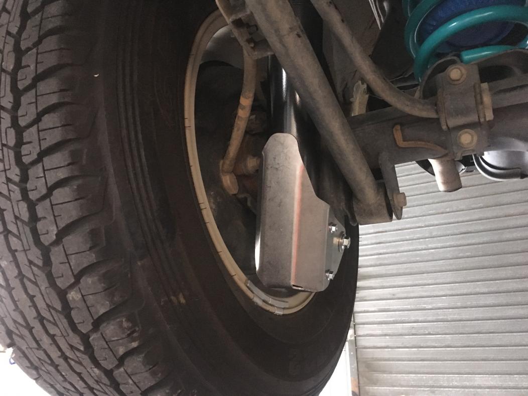

Upgraded design

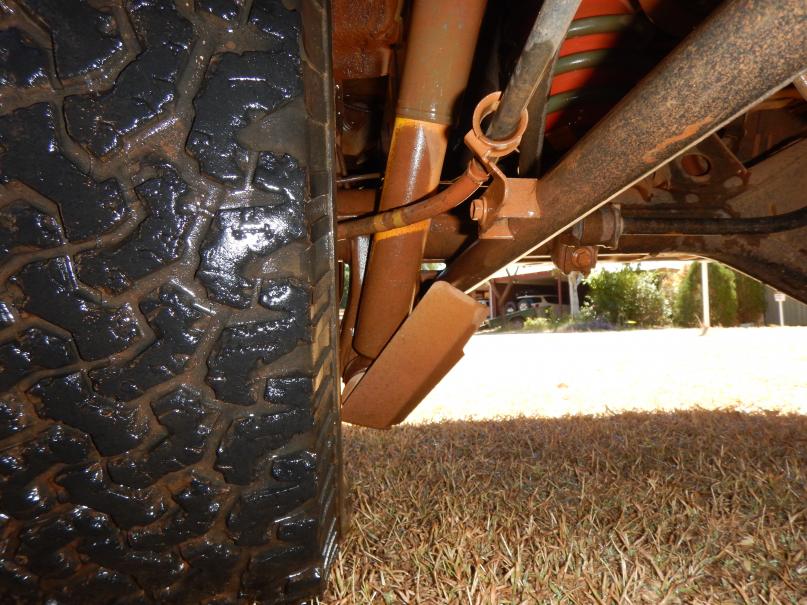

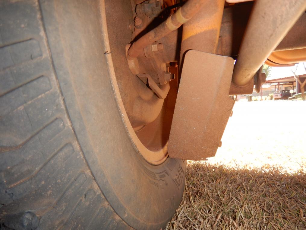

It seems that these rear shocks cop an absolute hiding on gravel roads. They also seem to get knocked around a bit when 4wding. The lower bolt head can get quite damaged.
So from feedback and comments I've beefed up the shock guards. They are now 2.5mm Stainless and are welded across the bottom gusset. This will help hold the shape better if it gets hit by a bit rock or obstacle.
I have also gone to hex style nut inserts that are less prone to spinning and slipping.
Shape is slightly different and there is plenty of clearance for the ironman shocks.
Will have some ready in the next week or so. Price will be slightly higher but will confirm once I get proper pricing for an economical batch size.
