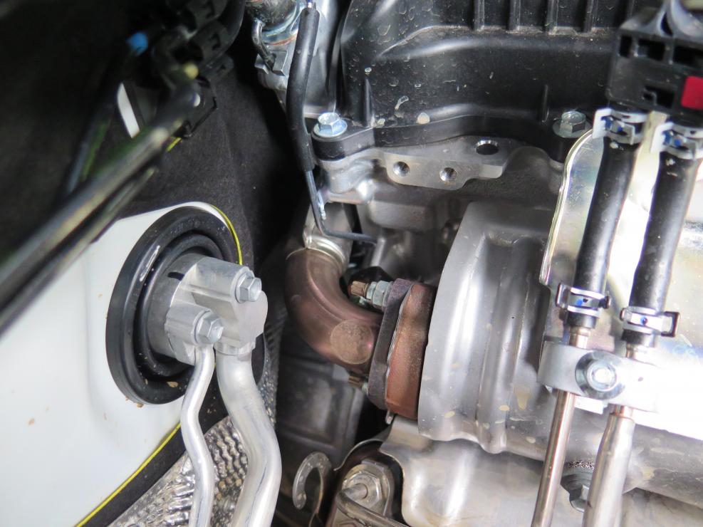

          This is the pic of the area between the firewall and the back of the engine in the 2.8, quite unlike the 3.0 and nothing to be seen of the breathers, too much piping in the way.

            Sarco, I reckon they are still there but you can't see them. The factory caps are on the bell housing which you can't see in your pic. This is backed up by John's advice.

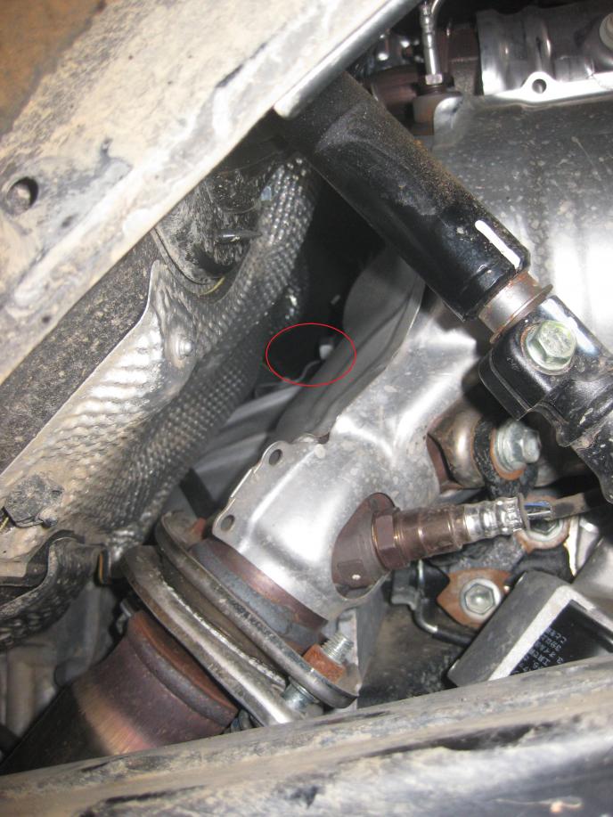

                      • Photo with hoses removed; just see white gearbox clip.
                      • Found best access from driver side; remove wheel; drop plastic cover; if hand, wrist & arm small enough can get between exhaust and firewall and remove 3 breathers from clips.

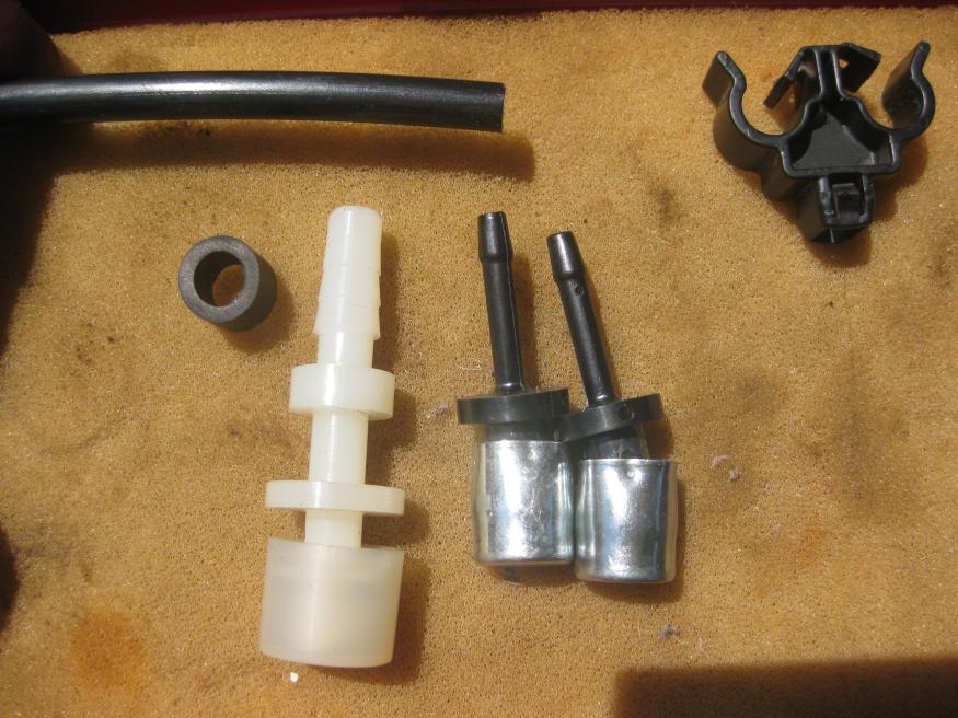

                      • Two transfer lines are long enough to drop below transfer to work on. As noted can use 3 or 4 mm connectors. Note the 2 breathers on the transfer are one way.
                      • Gearbox line is short and makes working on difficult. Note this breather is 2 way – this seems a worry. Had to cut about 10mm off hose to remove breather. It is larger hose.
                      • Photo of white gearbox breather & hose size; 2 transfer breathers and clip; AirOnBoard PV hose.
