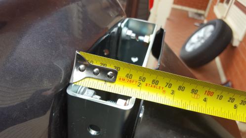

Just some photos and tips on installing a Kaymar WOD Spacer K7120 part
Used a nylon washer between the spacer and door so as to protect the paint

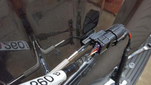

I decided to unclip the plug as there would have been too much tension on the cable when re-connecting the camera. Trick was to use a small flathead screw driver to leverage the clip and it slides off the bracket
Spacer added 2 inches to the tyre protrusion.
