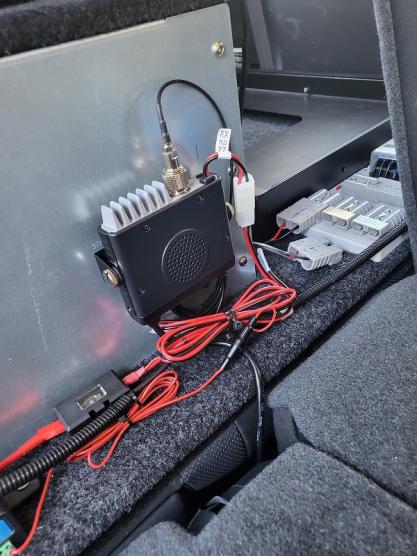

      If interested I did an easy option install for the UHF. I got a Uniden 5060 from Repco, on special to Road service members $224. Can do pics as it is screwed to the rear drawer, uses the Aux Battery, a Mic extension Cable and a small Mag Antenna on the roof bars.

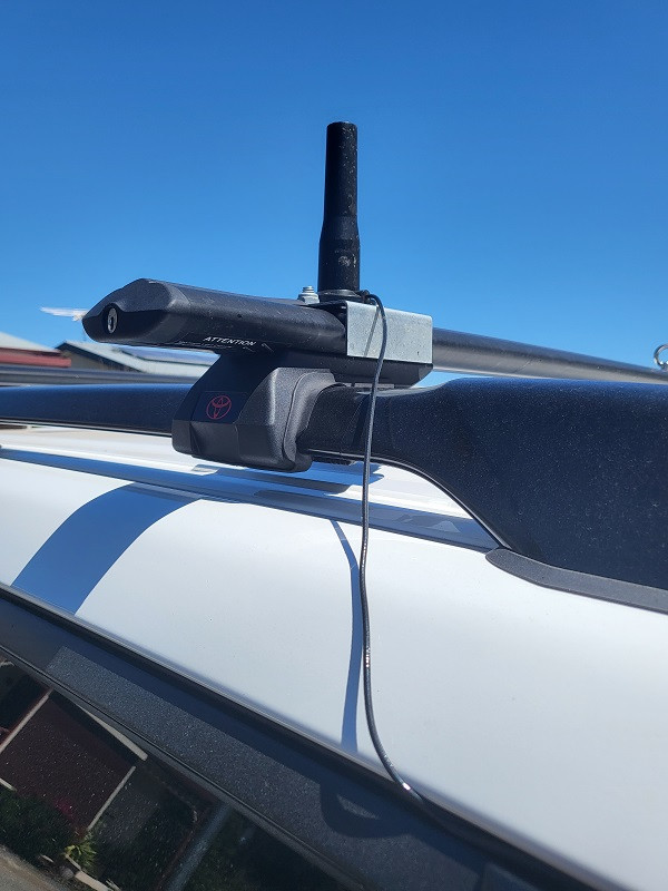

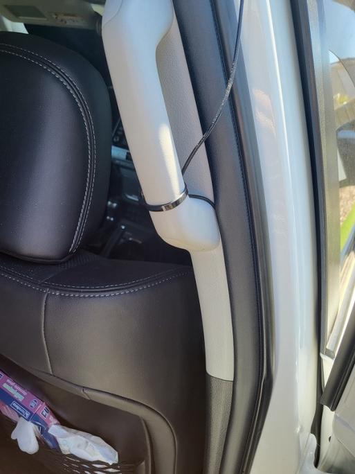

            Here are some posts on the Uniden UHF install - A small magnetic mount antenna on my roof bar is what suits my use, generally highway driving and hilly bushland. I got a galv steel bracket from Bunnings, drilled a couple of holes to suit the T bolts for the roof rails, rather than on roof, plus it is slightly higher. The Antenna is easily removed and tucked into the magazine pocket behind the driver seat. The cable is tucked behind the rubber seal under the rear door kick plate to the the rear of the 2nd row seats. The base station is screwed to the rear of the XTM drawer and powered from my added power setup previously described.

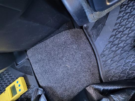

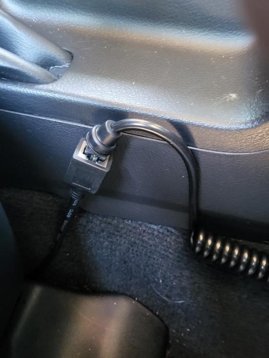

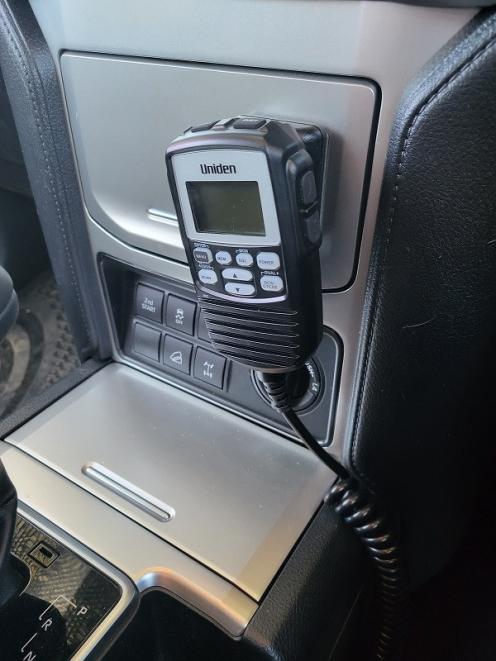

              The Uniden came with a 1.5M Mic extension cable which is too short. I got a 2M extension from Electric Bug (Adelaide). It runs from the rig under the 2nd row seats, between the driver seat and centre console. I have rear floor mats, so to cover the cable I tucked some marine carpet uner them and over the cable. (Left over from the false floor build) The female of the ext cable is Gorilla Taped to the centre console.

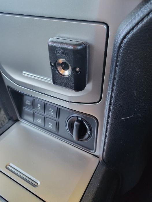

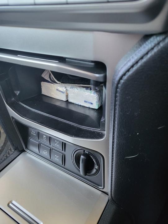

                I couldn't find a Uniden Magnetic Mic holder locally, however a GME fits perfectly and I got one from Repco. Using the Adhesive pad supplied it is stuck to the storage area door flap above the 4WD controls. Care needs to be used when positioning it; a. so you don't drop it behind the open door as it's a pig to get out. and, b. To allow the door flap to open and close.
                Job done - No need to run cable through the firewall or find power under the Dash. I do have a 3DB bull bar antenna (in the shed), the mag antenna is also 3DB and being higher should work as good as if not better.
Name:	7 MAG MIC HOLDER.jpg
ID:	767184Click image for larger version
Name:	6 HANDPIECE.jpg
ID:	767183Click image for larger version
Name:	8 OPEN LID.jpg
