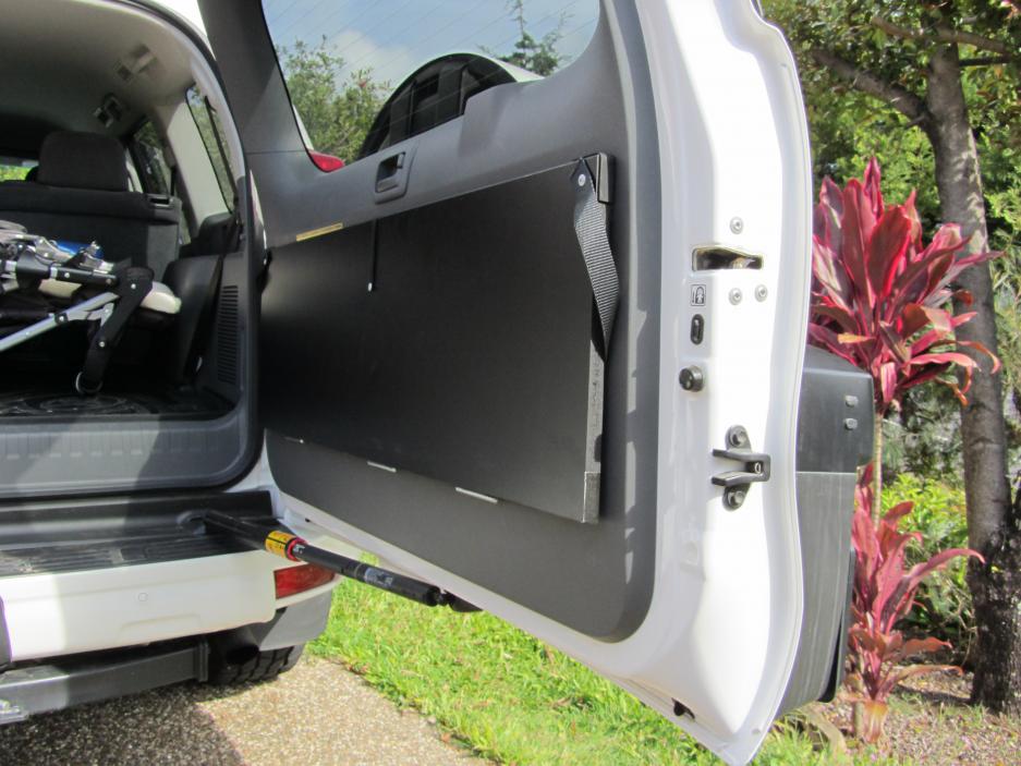

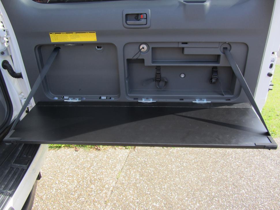

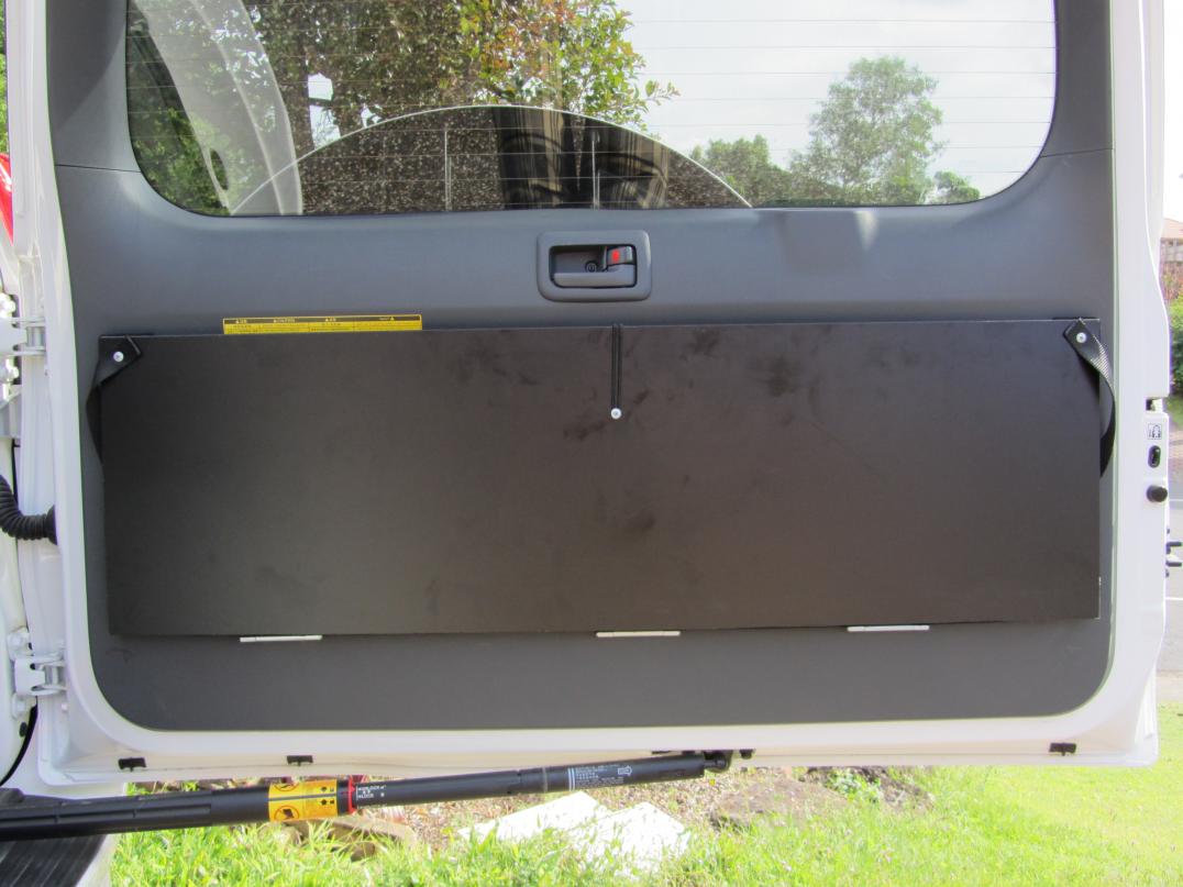

    Just thought I'd share a couple of pics of the rear door table I put together this morning.
    I didn't need anything too big and also didn't want to have any holes showing on the door face when table is removed (sale in future)
    I just used black Melamine from Bunnings, total cost approx $35 for complete install.
    It measures 1100mm by 330mm.
    Pretty happy with the result

      Reckon you should be happy. Looks really good
