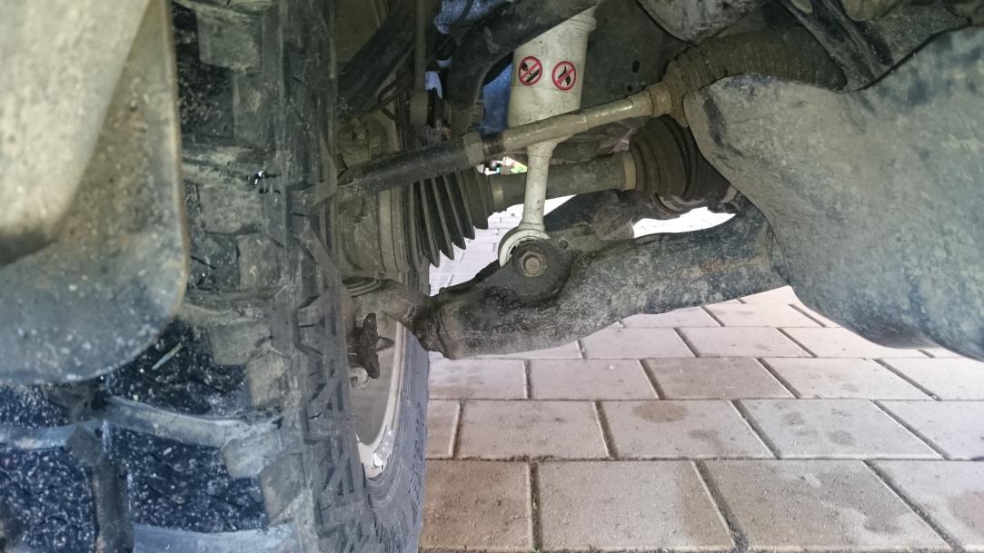

What is interesting is front droop is 110 mm and only 55 in the rear. Does the rear sound short?

I really like how it looks but is the front too high for cv angles?

Don't want to kill a cv down the beach this weekend

I would avoid driving your Prado at high speed, with only 25mm of droop and that high front ride height it will lift a wheel on a cambered high speed bend. I have driven Prados with low droop at high speed, and it can get dangerous.
Can you specify your strut and shock closed and open lengths, and specify the free height and spring rate of the coils you are running.
These numbers will help clarify why you have so little droop. I'm guessing you have short open length struts with coils that are too tall.
Such low droop figures have been seen before, it's not unusual, but it is of course a big problem, and you struts/coils are almost certainly mismatched.

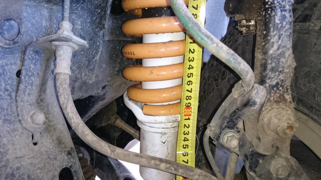

Front strut is 24750fe 552mm-425mm part number off struts
Spring is toyo65b 370mm part number off box
It was sold as a kit matching kit I dunno I'm confused I have
265 70 17 I measured from bottom of rim to gaurd
Struts and sprngs appear to be assembled correctly doesn't look like there is a spacer
It has superior engineering sway bar relocators does this matter

The front is too stiff for your loads. It won't settle 20mm.
From memory stick height at the front with 17" wheels is 750mm so you have 80mm of lift. Too much. A 1" diff drop might be ok but you have virtually no droop. That is bad. As Mark aphasia said it will handle poorly and dangerously. If you aren't adding weight up front like bat, winch and battery get softer springs.My 150 build - http://www.pradopoint.com/showthread.php?27423-A-Random-approach-to-a-Bluestorm-150-GXL-D4D-automatic
