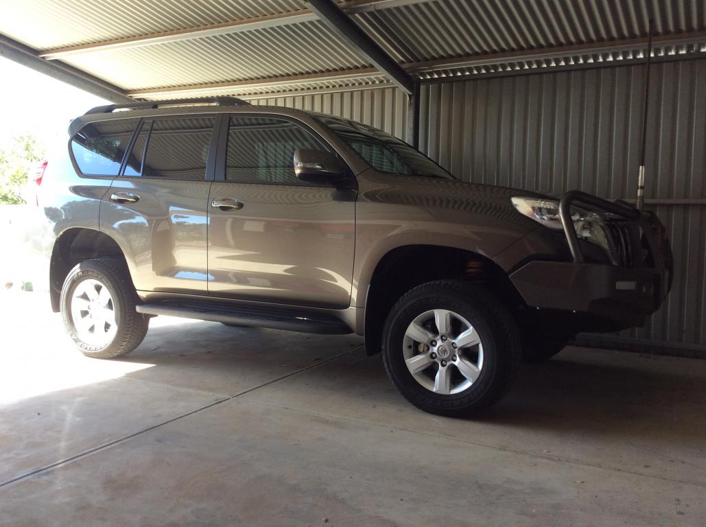

        I,Ve just fitted cal offroad 2" silver bilstein struts/bilstein rear shocker with king springs. King springs are front comfort taper and rear are HD. Had to play with the front set up a bit to get the 150 sitting level after receiving the kit from cal,s. The silver struts have 4 hieght adjustments for the spring base so I,Ve set mine on the second groove up from the bottom. It now gives me the following heights with a 5 mm spacer on top of the front struts
        Front 820mm
        Rear 850mm
        Look level and sits perfect on the road now. Not happy at first but are a few adjustment more than happy.
        Initially when I fitted the front struts that were supposedly assemble to meet my requirement the front was to low (795mm) and to soft. Up one cerclip position and a 5mm spacer fix it for me.
