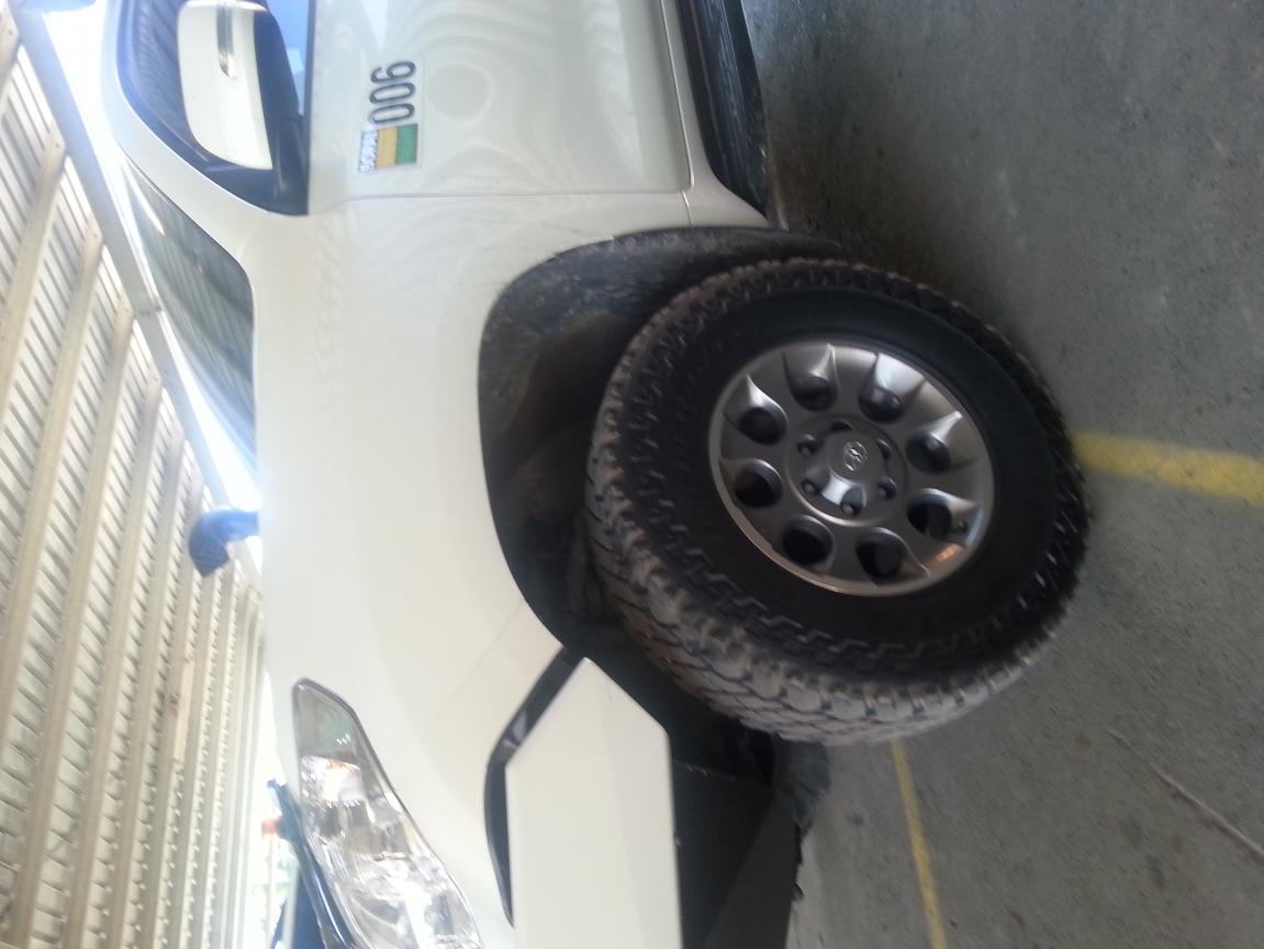

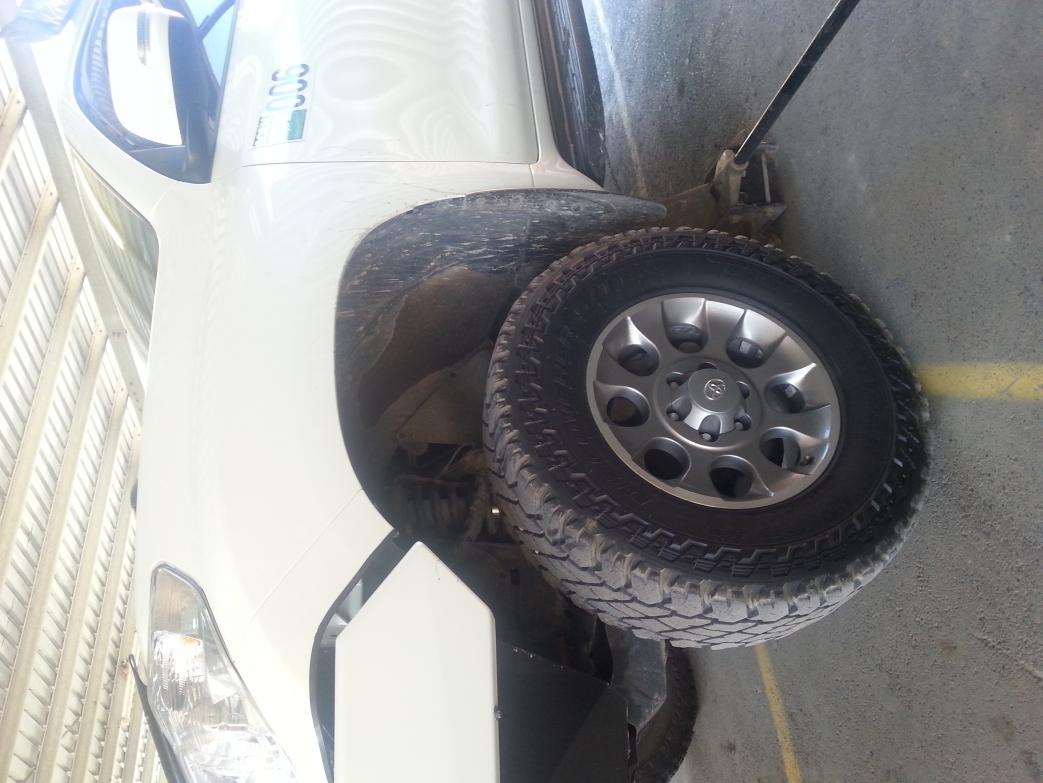

  • christofurry
  • christofurry
    replied
    Rim to guard 810mm wheel on the ground
    Rim to guard 915mm wheel off the ground
    Leave a comment:
