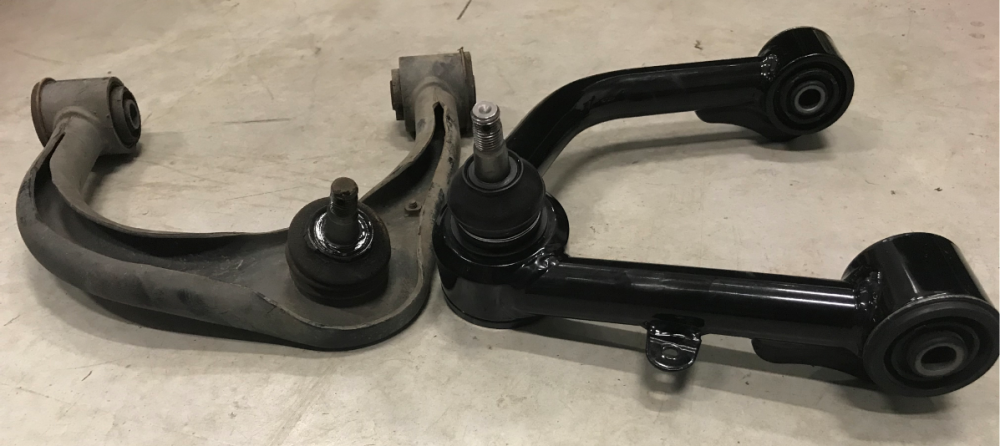

                        UCAs are here.

                        Hopefully get time on the weekend to fit them...
