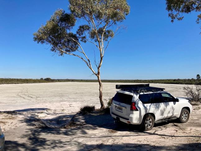

ID:	764921 I’m running a set of AT3W on a new GXL with mods including a rhino platform and bush company 270XT awning. A recent trip to Little Desert had me dropping pressures to 18psi and I got me thinking about my road pressures. I was running at the factory recommended 29psi which was also the pressure set by Bob Jane when new tyres were purchased. Recent posts had me upping these pressures to 38psi similar to other previously owned vehicles with the reasons being better wear vs comfort. What I can report to those interested is that to my surprise after 3 months of road (highway and city) use fuel consumption is exactly the same 11.0/100km. (Ambient temp these 3 months have been quite low 2-15deg C.) Anyone have similar or differing experience???

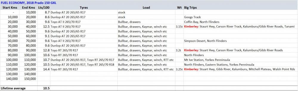

    Economy is heavily dependent on tyre type (eg Hwy vs AT vs MT), tyre size, air speed (not ground speed) and frontal cross section.
    My economy stats for the first 130,000Kms:
    Click image for larger version  Name:	Economy to 130000Km.jpg Views:	0 Size:	66.4 KB ID:	764923
