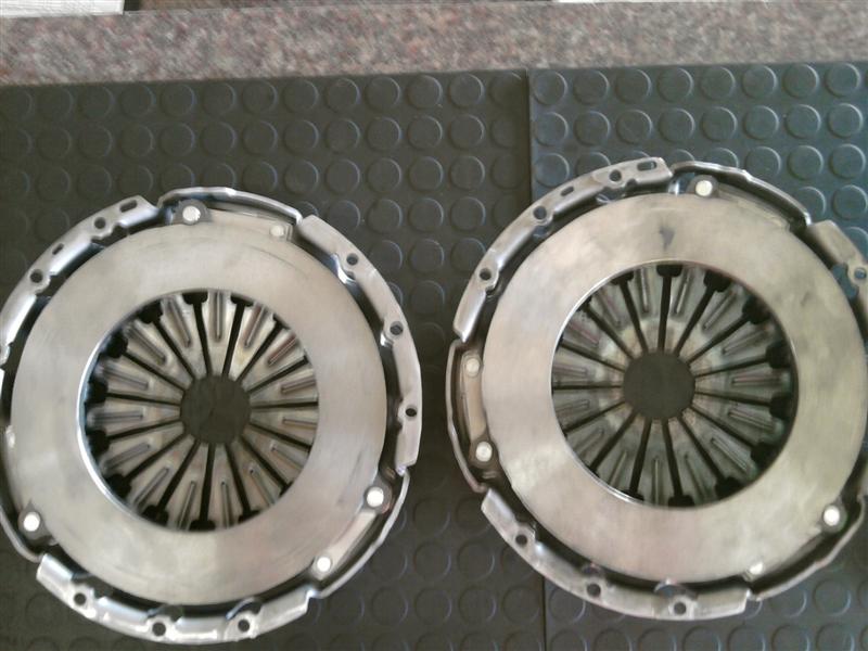

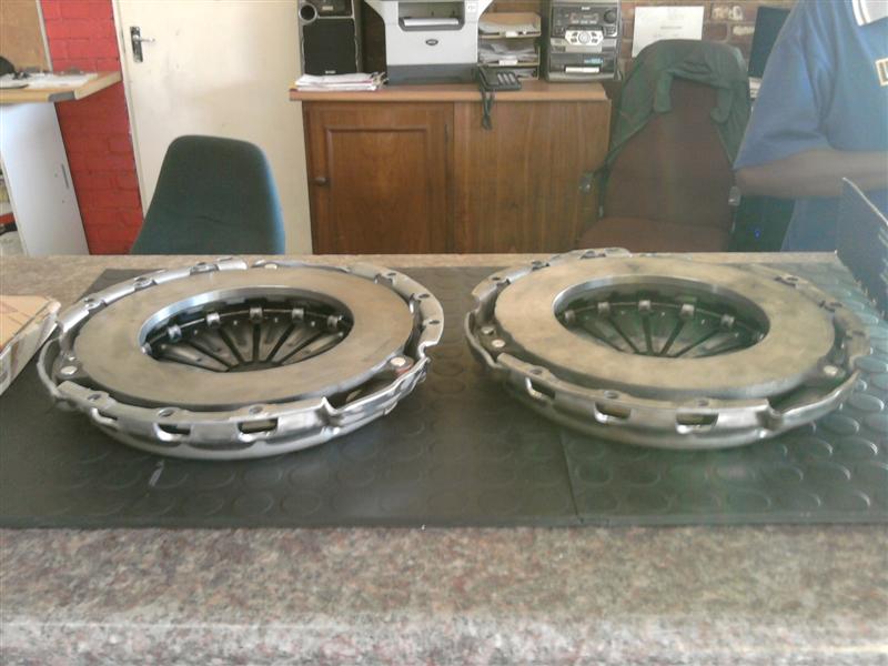

    Below are some pictures of the two clutch kits:
    "Genuine Toyota" on the left, Sachs on the right:

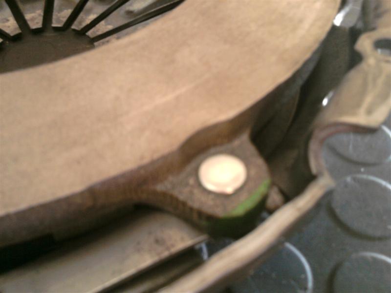

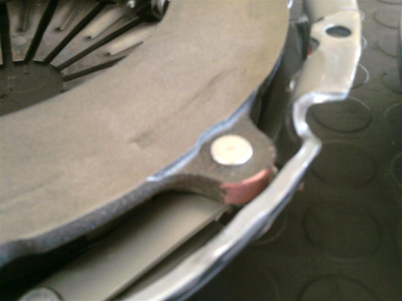

    "Genuine Toyota" pressure plate:
    Sachs pressure plate:
