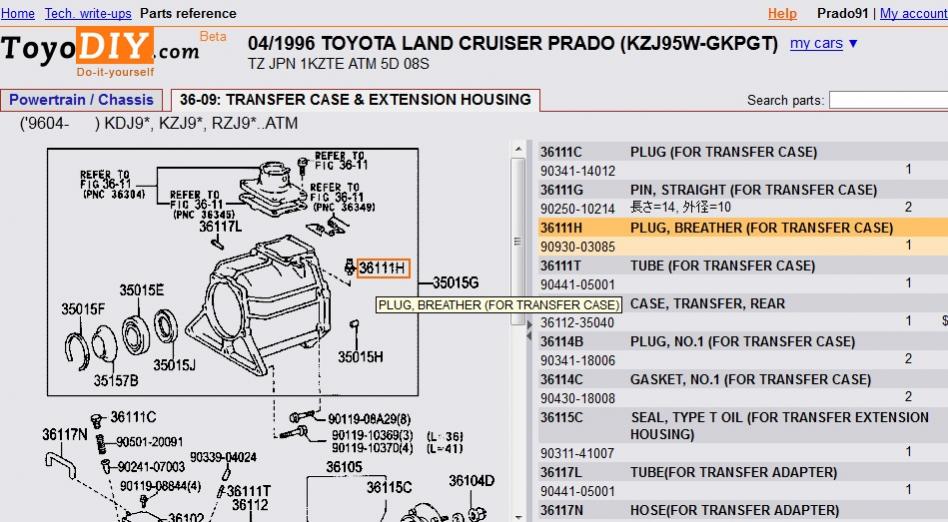

Anyone have any ideas to extend the transfer case breather plug... When I went underneath to check it, it seems you cannot unscrew it as no wrench hold n it's flush with the transfer case body. It's not like the rear axle breather where you can use a wrench to unscrew it. Hops you guys can help me.

I'm not sure about the transfer breather either
All I found to be removable was the cap.

any 90 series owners have any info on how to do this?Prado 95 3.0D Turbo Auto Series 1997, 285/70/16 Bridgestones AT 694's on 16x8 rims
