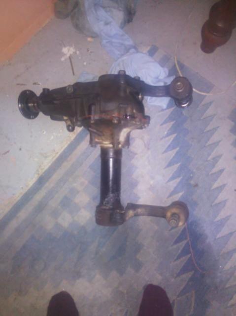

Diff gave up far from home, pinion nuts fault perhaps
    So ive started the rebuild. First i measured the bearings to check they were the same size as the originals as any change here will affect pinion height which would cause a lot of complications. The outer bearing race/cup went in fine. The inner one didnt. Its hard to hit it in there due to the access angle and its super tight. Ive checked the OD with the original and its the same.

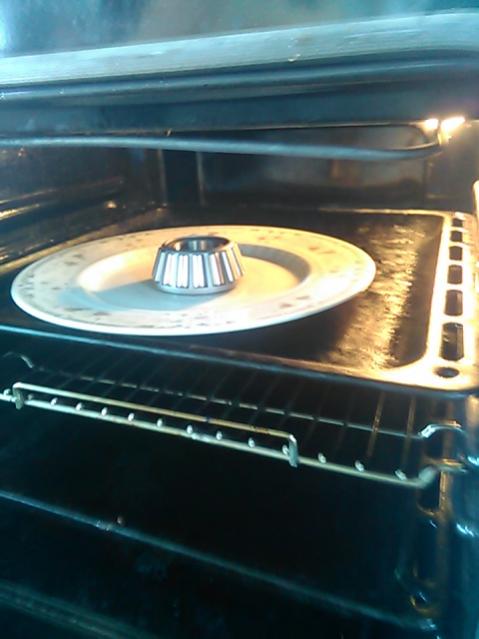

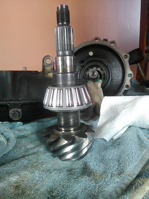

    The pinion shaft bearing was the same issue. I did the heat up the bearing in the oven trick (90degsC). They have a service temp of up to 120degC.
    The shaft went in the freezer overnight which was set to -18degC.
    When i quickly pulled out the bearing and hit it with a pipe (on the inner ring) to try and get it to go down, it went down only so far.

      Well pressing on the bearing was very easy. A small press was all that was needed. I didnt add any more than the original shim. The new bearing had a bit of a lip on its lower which made getting it on straight very easy. The piece of metal next to it is the crusher sleeve. As ive written about before i decided to reuse this. So ive bashed it in the middle with a mini sledge to lengthen it out somewhat so it can be recrushed.

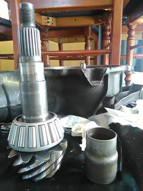

      The next job was to put in the rear bearing cup. That was the hardest job of the day. To get it in it needed to be hit perfectly square on, but the position it sits in in the diff makes this difficult. I tried a slide hammer (heavy duty size) but this didnt work. The way that it got on in the end is that we undid the oil filler nut and put a slightly bent extension bar through that hole and then had an old universal joint (bearing cups removed) up against the end of the bearing race. My job was to hold the bar in the middle of the UJ while he hit the end of the extension bar with a large sledge. Non traditional method but to my great relief it worked and many bashes later it was seated nicely, flush up against its stop.
        Next job was to install the pinion and put the pinion preload on.
        This involved oiling the bearings and putting the pinion in then slide the crushing sleeve in then the top bearing, which presses in when you tighten the flange. The big washer/oil slinger went on next and then the seal. This again was tight but the flange makes an excellent seal install tool so i tapped it in with that. Before you do this job you may want to check the depth of the seal and the stop where it rests against that way you have a rough idea how far it needs to go before seating.
        I coated its outer in a permatex sealant and drove it home.

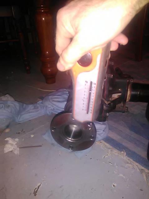

        The next step was to coat the thread of the pinion in threadlocker and put some grease on the seal lip and flange and then install the flange. I then put on the nut and started tightening it down. Here comes the most complex part of the day. As you tighten the nut it compresses the compression sleeve between the two bearings. This requires something solid to hold the Flange. Some people make tools, i used a massive pipe wrench i have. You keep tightening until the bearings become seated in their race and until the turning torque of the flange wheel reaches a certain spec.
        New bearings require more than old ones. For reference I have new bearings at 10.4-16.5 inch pounds and old bearings at 5.2-8.7 inch pounds.. Yes thats inch pounds. This is without the carrier housing in there turning, its just the pinion.
        So i dont have a torque wrench capable of such a tiny amount so what i did was i took a middlish figure of 14inch pounds and i took the distance from the nuts centre to a hole on the edge of the flange, which was 4cm. I converted that too 1.6 inches. I then converted the 14 pounds to 6.35kg.
        I then divided the 6.35kg by 1.6 which gave me 3.9kgs.
        Then what i did was i put my fish scale measuring hook in the hole at the 1.6 inch distance and tightened the nut until the turning torque was around 3.9kgs. ( I checked the accuracy of the scales on yoghurt containers). Since i used the middle figure i picked i could be a bit off.
        I had to tighten it slowly as the bearings load up fast when they touch. Its hard to explain how it feels by hand to turn the flange at this torque... Perhaps about the lightest amount you would turn a tap off with.

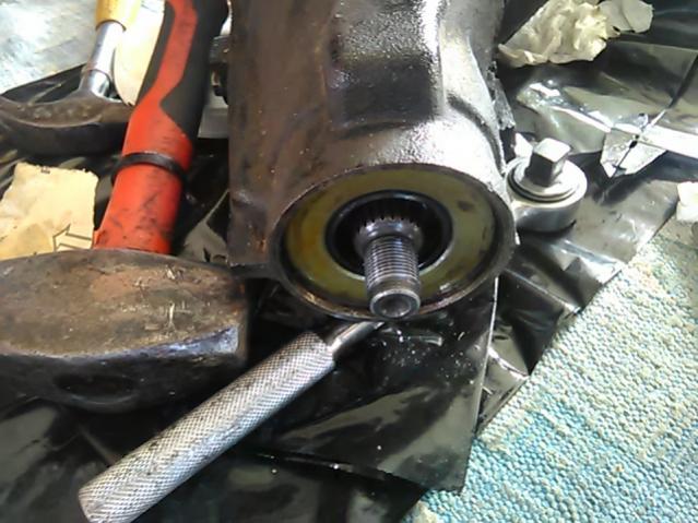

          Next job was to stake the nut, and even for this seemingly menial job i can see why they use a specialised tool. It took a lot of time with a punch and screwdriver to get it in a form that i thought would make the nut unlikely to loosen off.
          By the way the nuts size was 27mm.

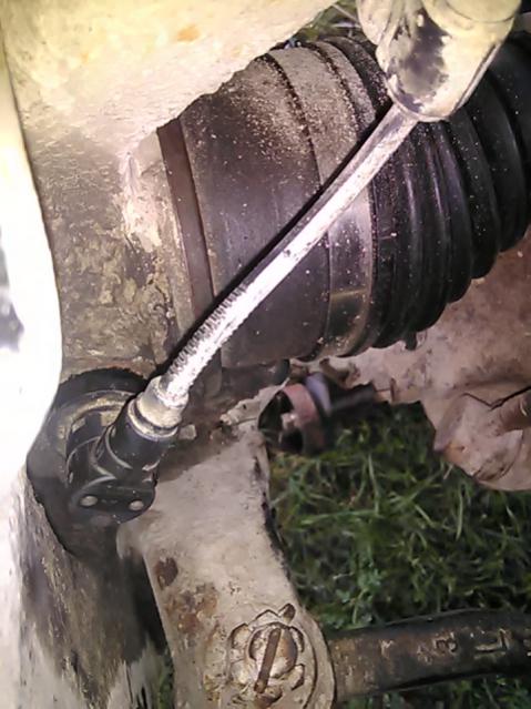

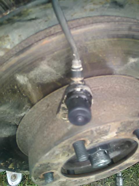

                  What has being happening is the abs light has being coming on now again. I took the abs sensor out of the wheel housing which is really easy. Its a10mm bolt and then you just gently wiggle it out. It was covered in a bit of grease and a bit of metal from a spring. So what has happened is Ive ended up damaging the inner bearing seal while ive being putting the half shafts in and out. So i will need to replace that sometime. Looking at it itl be an easy job. I dont think the seal will be expensive.
                  The spring was clearly interfering with the magnetic signal which generates the abs. The warning light has not reappeared since ive cleaned it.
                  So if doing this job do be careful when replacing the front driveshafts into the wheel housing.

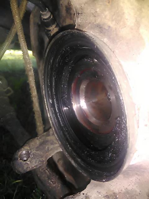

                      Time to do the inner hub seal. An update on the diff first. Its being running quite well, ive done about another 60km and the temperature in it has actually reduced. Im not sure if thats due to the heat and cold cycle affecting the bearings settling down into their seats. I know that on new ring gear setups you have to stop the car and let it cool during its first few runs. Ive had to remove the prop shaft, not because anything is wrong, its just because ive some very important meetings i cant be late too so i thought id remove it and then put it back on once those are done. Checking the preload on the diff pinion now it has freed up some more. The nut is in the same place. Previously it took a bit more than a touch of a force to get it to turn, now it turns freely but not too freely. Hard to explain but it feels promising.

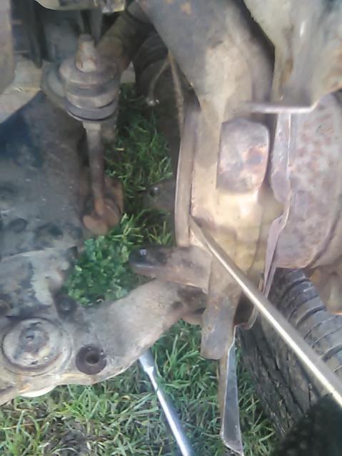

                      Now on to the seal. It was a very easy job and a pleasure actually to get it done, plus a necessity as moisture in there could wash out the bearing and also it will allow for rust.
                      To remove the old seal just took a small flat edged screwdriver and tapping with a hammer
                      Once removed i could see all the mess from the old seal, it definitely needed cleaning out. All that rubbery stuff is actually embedded with the metal spring particles which could well cause more problems down the road. I brought the hoover out to clean it up as best as i could.
                      Installing the new seal wasnt too difficult. I had tied up the brake caliper out of the way and also slid off the rotor so i could rotate the wheel hub housing on the top ball joint enough so that i could get to the back of the hub quite easily. I just pushed it in by hand and then tapped it in with a hammer around the edges using wood when i could. I also put a bit of permatex around the outside of the seal.
                      Last job was to clean the abs sensor
