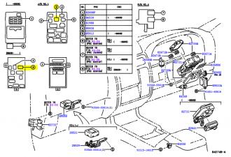

    Hi, can anyone help me, am look where i can find the flasher unit on my Prado 90, 1999, thanks in advance
    Hey Mate, I'm assuming you are talking about the flasher relay, which is located in the fuse panel under the dash, I have highlighted it in the picture below, Cheers

      If you see that big box on the right of that picture the flasher replay is mounted on the back of it , you will need to unbolt that fuse box assy to get to it
