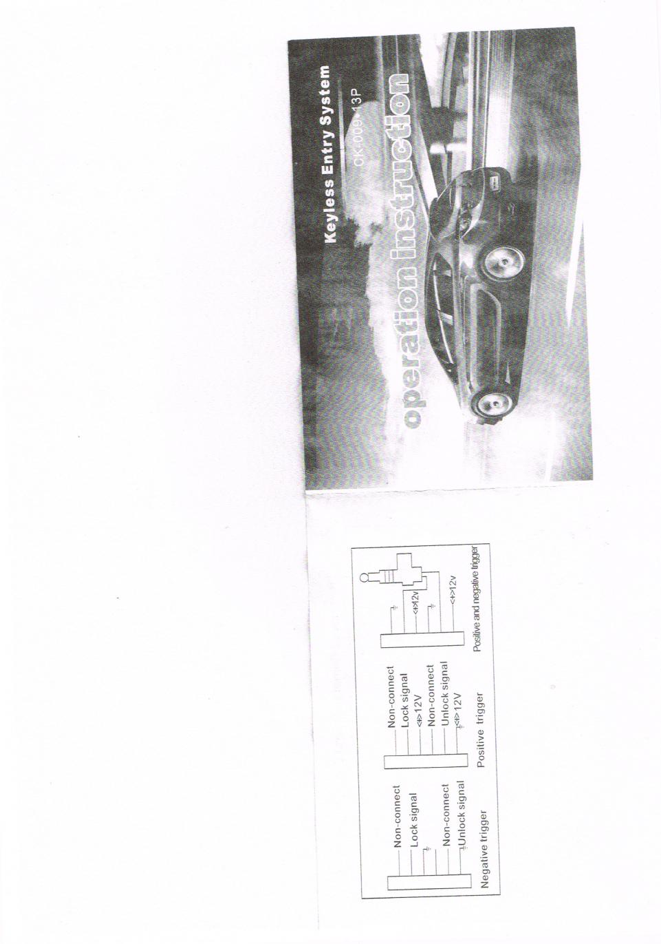

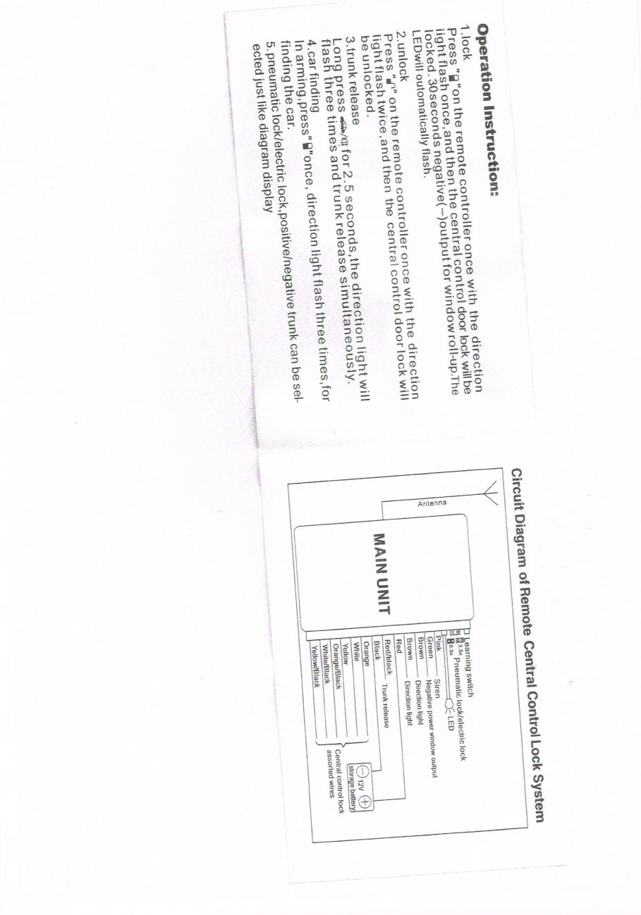

    Just bought a keyless entry system off the internet for the prado, 1998 Grande VX. Its a model CK-009.13p which seem to be fairly common.
    As usual the Chinese installation instructions are useless and I have no idea where to start. I have the wiring diagram for the locking system in the prado, but cannot see how on earth the remote control system connects to it.

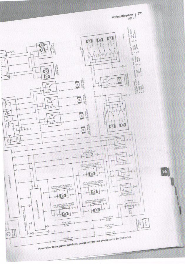

        Mate your saviour is here! I live and breathe alarm systems and can help you very quickly. I'm out and about right now but if you could post up a picture of the wiring diagram I can step you through it. Also, feel free to PM me with your phone number and I'm happy to have a chat. Once you understand them, its not that daunting.
          Great thank you I will do a copy of the wiring. Do you eed both the remote sytem and the Prado's?
            Wiring diagrams
            Here are the wiring diagrams. I think what may be confusing me is the bundle of wiring coming out of themain control unit. I suspect I only have to use a couple of them.
