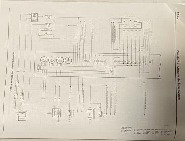

All the wiring diagrams suggest it has a VSS attached to the transfer case and we cannot find the correct wiring diagrams for this model.
Does anybody have the correct wiring diagrams or can suggest if there is a speedo sensor attached to a part of the car we cannot find. I'm out of options now as 2 recommended auto electricians are stumped too so maybe someone here can help!?
