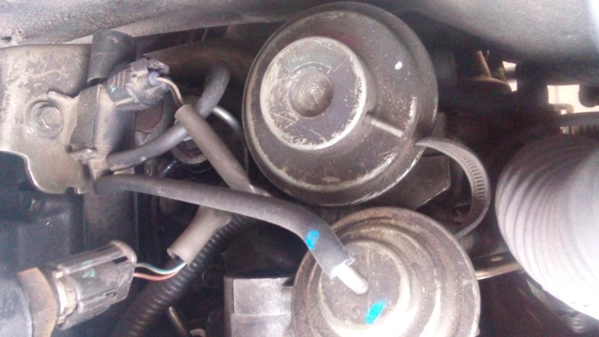

            Does it have an EGR valve, something like this? http://www.4x4toys.co.uk/images/4x4/.../1kzte/EGR.jpg
              Hi adrian5800,
              I'm not sure if the EGR valve is the same, but mine looks like this.
              I've been observing the problem and this is what I noticed. Whenever the problem occur, I noticed that Intake constrictor is on close position, as if there's a vacuum signal from the VSV to the actuator. I've checked the VSV, but it seems like ok (it functions as I apply 12v voltage across the terminal). Anyway, I'm going to replace the VSV first and see if the problem is solved.
