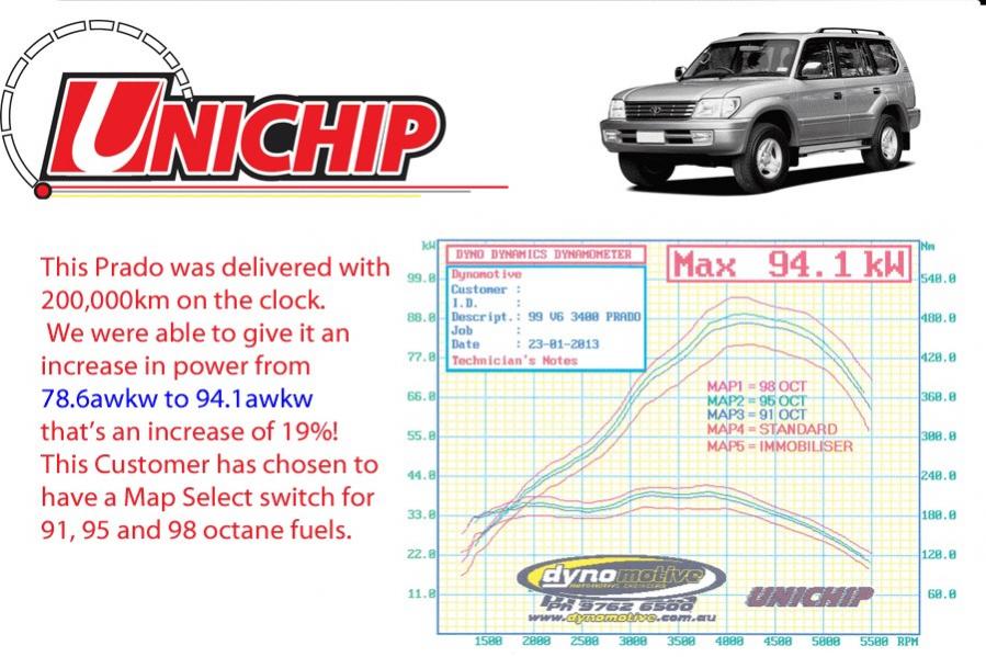

                    I have also put pacemaker extractors on and a 2.5 inch exhaust out to the rear. Just putting the new exhaust on helped a lot and I think it was worth the money. All up the exhaust cost me about a grand but I did most of it myself. The chip only went on 2 weeks ago and I think it has really made the car run smoother and seems to have more power throughout the entire rev range. But I am still to put a entire tank of fuel through. I think the best thing about the chip was the power gain from 78.6 awkw to 94.1 awkw. Not a bad 19% power upgrade. I can not comment on if I am getting better fuel economy as I have been having a bit of fun with new burbs. I can post up the dyno map if you want to see the difference.

                            As for the Dyno charts, well I’m sure that they would be interesting to see by the people following this thread.
                            Looks like I’ll have to add fitting a new exhaust system to the growing list of work to be done, and believe me it’s a bloody long list, sigh…….
                            Be interested to see your fuel burn comparison, sounds like it could be better, ie better grams per kilowatt hour, if it is actually more efficient now,. Or has it just unleashed more of the available power that Toyota wouldn’t let you use ? In that case your gr/Kw/Hr will be the same.
                            Just have to watch the right foot now I guess, and see if you can get a fair comparison

                              Looks like I am not getting as good as Leethal's power but I will need to save up a bit more before I put a blower on. Sounds like a lot of fun though Leethal. Filled up tonight and even with all the 4x4ing we did on the weekend and the bit of fun I have been having pulling people off at the lights the fuel economy is 15L/100km. Ill try and take it a bit easier this tank and see what happens. I bought the headers for $400 from a exhaust importer here in Vic and the exhaust was used as a template.
