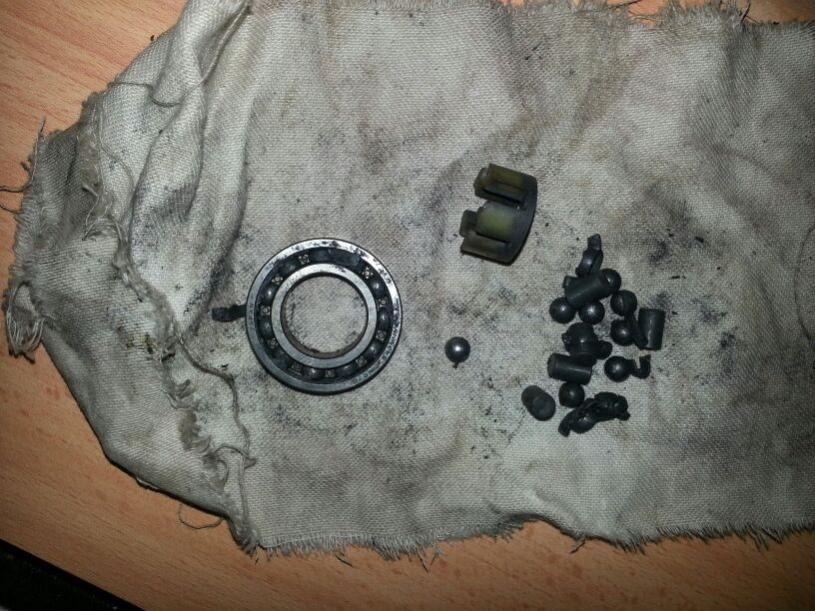

                          I got the starter out, was fairly easy- used LONG extension (bars joined up) and a goose neck connector for the angle- both bolts came out in under 5 min- took me longer to get the dipstick for the G box and break line out the way- left the power steering lines in place too.
                          Anyway.... got it out and notice something odd.... so i opened it and this is what came out......
                          So nope.... not the contacts..... they were fine.... so now full starter rebuild!
