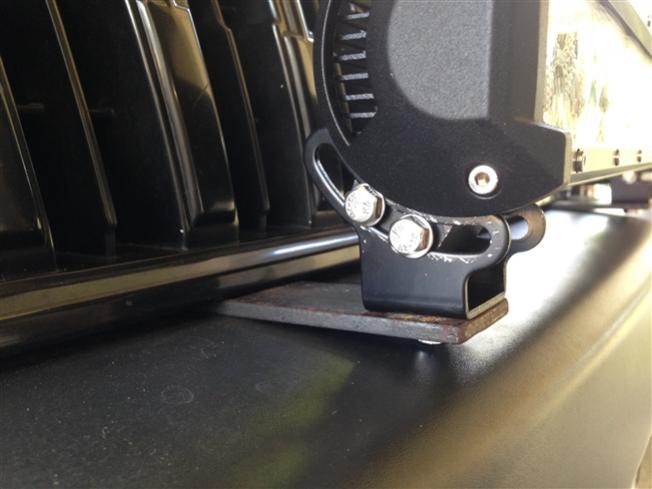

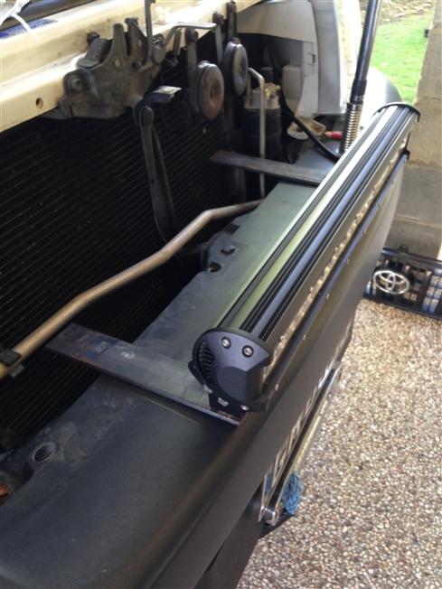

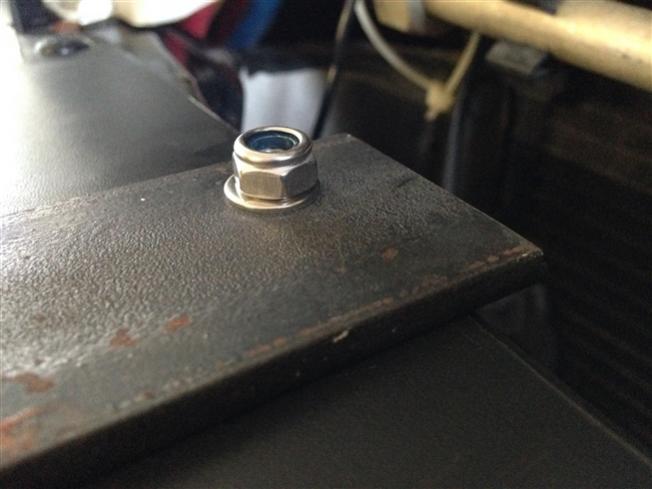

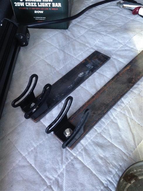

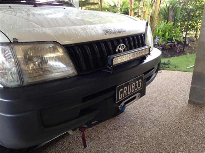

            • Got my LED 22" light bar fitted last week finally.
              Just some photos of the custom mounting install for the light bar.
              Switch mounted onto dash, hooking into high beam at the stem.
              As I have no bullbar, the light got custom fitted to steel rails which slides underneath the grill and attaches to the frame below the bumper bar.
              I also got the steel rails zinc plated before coating in stone-chip black paint, lots of rust here on Sunshine Coast.
              All hooked up and works a treat, same problem as everyone else though, standard high beams look a little dull

              • That's pretty ingenious mate. Well done.
                Blake
                • Good job, light doesn't bounce?

                    • nah, it is very firm with the downward pressure from the grill, i also put bike tube underneath the rails so that is doesn't move left or right etc
