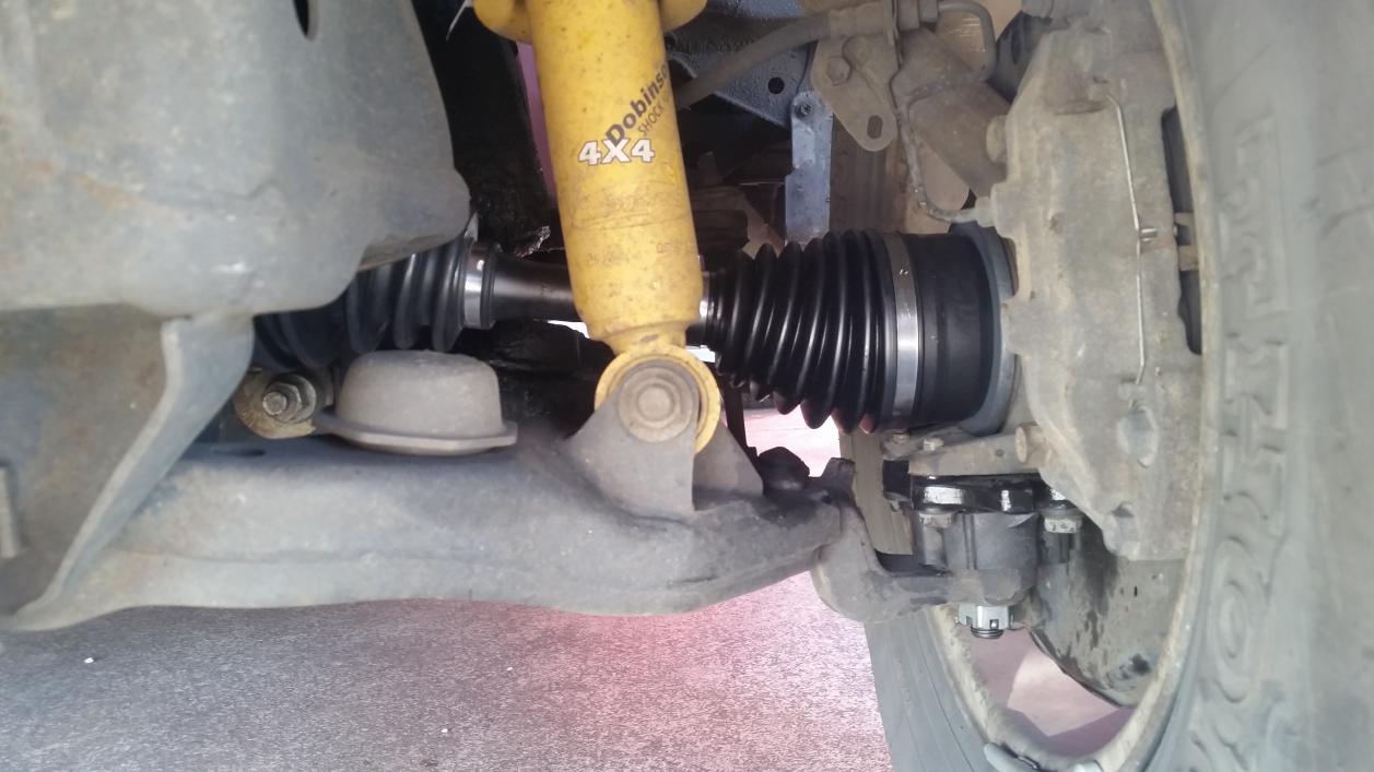

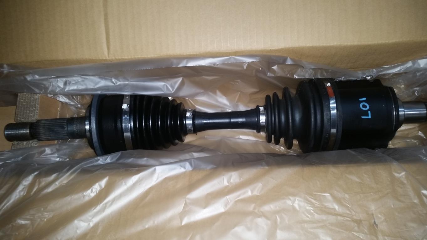

    How long do the front cv's last? I noticed the boot on 1 of my c/v is about thorn in half and on the other side it appears the front diff seal is leaking Im about to replace the front c/v joints and the 2 front diff seals. My prado has 255 thousand k's on it when I brought it I thought the c/v joints were pretty new then, how long on average did every one else's last. Any thing to watch out for when changing the front c'vs ill try and order them this week or early next week.

    Ive done just under 300k and I'm about to change them. Only because the inner boots are damaged and lost some grease.there not making a clicking noise but im guessing that the loss of grease has let them vibrate now at certain revs. Im putting toyota back in.

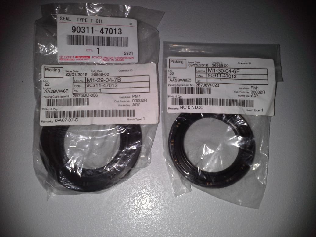

      you going to do the seals in the end of the IFS housing? Do you know the part numbers by any chance?
      I was going to put the ebay specials back in mine.

        yes im changing them, right side is 90311-47013 and left is 90311-40712
          Mine has done a very hard 201k and we replaced the boots just before Christmas as they were so stiff they kept pulling off.
