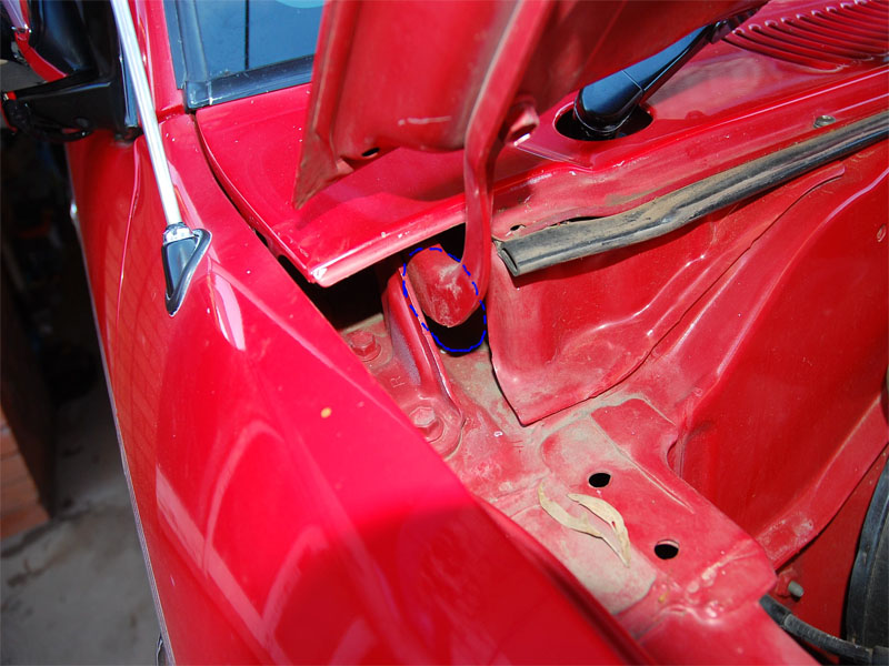

    After thinking for a long time, I decide to make a crazy plan that the snorkel will go to the center of the front panel, some where under the hole of front glass wiper.
    I take off the driver side cover on the fender. I found the way that my Prado breathes.

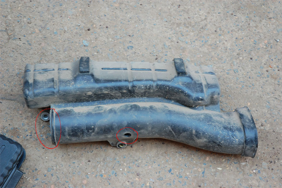

    I intend to create an external plastic pipe (or rubber pipe) from the last point of the original pipe (big red circle), then run that external pipe along the fender and up to the surface just under the front cover above the front glass wiper ( The blue circle), of course I will have to drill a hole for the pipe where the blue circle is, but at least my lion will NEVER KNOWS that it is what I did because she never looks what is under the hood
    As I thought that, this place will have good air, also it does not have much water even if with the heavy rain or whenever we clean the car. And I can make the pipe curve with my modification, so the water has no way to come into the pipe.

    - The original plastic pipe has one small hole under the bottom (the small red circle in the first pic). Is this the hole for water goes through if water has any chance to get into the original air pipe?
    Because I intend to cover this hole when I do my conversion. Actually if I still keep this hole there, the water will get into it easier.
    - Can I replace the big plastic pipe there and just add a long plastic pipe from the point where the air filter start working on the fender? Is this option better than keeping the original part? Will this affect to my Prado's breathing?

    Simple answer would be no.
    By doing what you suggest, it would appear you are creating a channel for water to follow directly to your air intake.
    Additionally, there is no supply of clean air in that area. You will be sucking dead HOT air from the engine and it will drastical kill your performance.

      Yep, first time water comes over the bonnet you have a direct channel of water into the intake... Also, the induction noise would be a lot louder. I assume that would cause all sorts of family harmony problems.

        I think that its probably not a good idea either!
        Simply put, the idea of a snokel is to get the air intake as high as practical and away from any potential water ingress.
        Currently, your intake is in the vicinity of the engine bay, and after your mod, air intake will still be in the vicinity of the engine bay, ie no change and no benefit. Which may also lead you into a false sense of security when it comes to water crossings. I'd personally go with either fitting a snorkel correctly (no loving for a long long time), or not fitting a snorkel at all (keeping missus happy - lots of loving!)...

              What about that big hole OP found in the existing plumbing? Should that hole be there in the first place?
