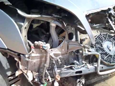

      Now that I have seen the video I reckon it is a bit dodgy. I doubt the chassis would shear square across like that without a defect or stress raiser. Could have hit too many water barrels with the Smartbar and changed it back, what do you reckon? Agree with your comment about sand too.

          Hi guys
          Wafra's offroad prado incident
          So according to the Vid its the difference between doing a bungee jump with a chain/ Leather strap or an elastic band!
          The first two will rip your legs off and the last one launch you and you get to keep your legs and if the correct strap is used (Load to weight) it should snap before ripping the chassis leg off!

                    Looking at that video,
                    Are you saying that rated recovery points would have stopped the chassis from being ripped off? or does it show that the factory loops are stronger than the chassis, and the argument is academic?
                    I'm confused
                    The video shows that if you snatch from one chassis rail alone, you risk breaking the chassis. It also shows that the vehicle is a 2006 or later model, which has much stronger factory points than Ant's 2003 model. Sorry, I still wouldn't snatch recover you with factory points
