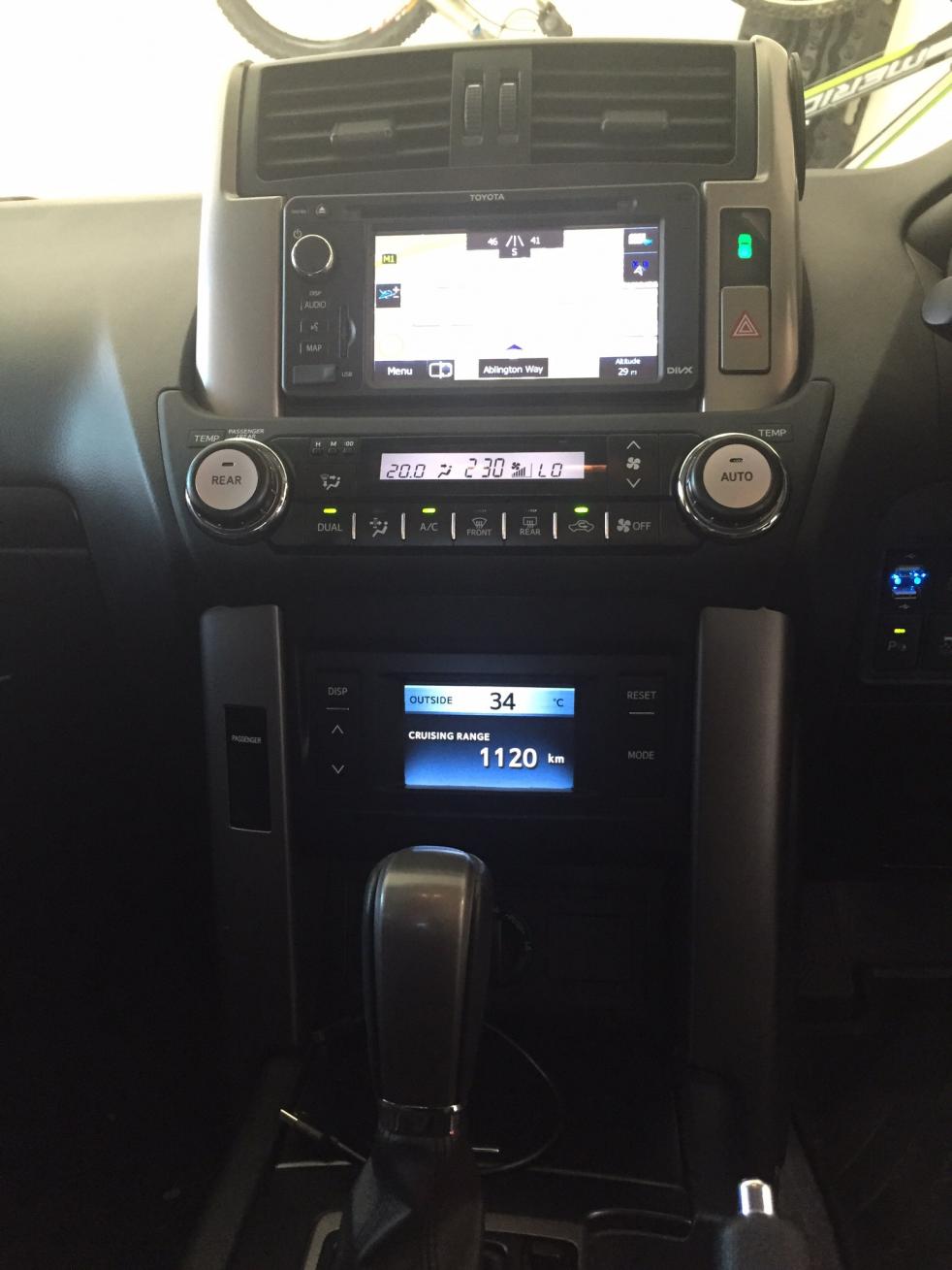

        This is the Air On Board version for the 150. I haven't installed it yet, but just noticed there is a blue light within the USB sockets. Don't know why they put lights in at all. It does however have a cover so both ports/lights can be covered when not in use.

          Yep. Can confirm that the 120 version does have the blue light. I don't think its too bright, but I have it installed down under the ashtray where it's out of line of sight when driving at night.

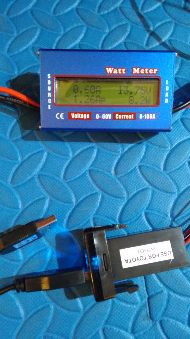

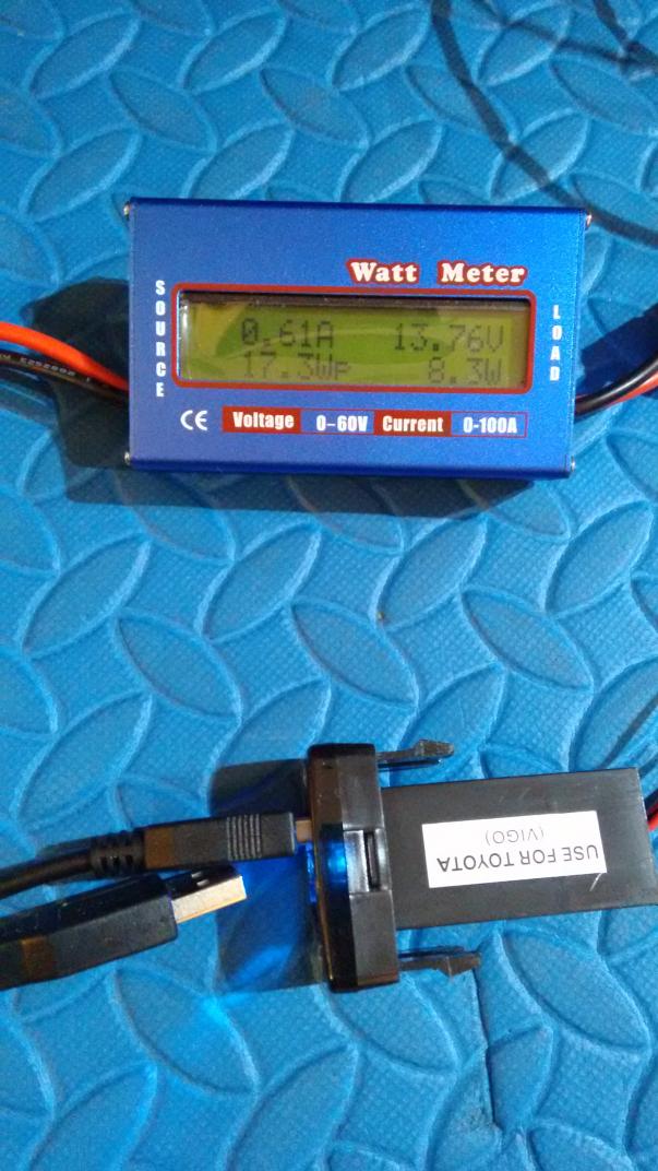

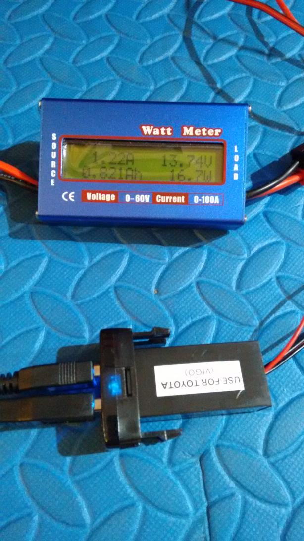

                        I have 2x Nexus 7 and a Motorola Moto G for testing. I used a Watt Meter to get the power readings on the 12V side. A Projecta IC700 charger was used as the power source. Its output is 13.74V.
                        If I only plug in 1 device to any of the ports on the charger, I get a reading of 8.3W (1.66A @ 5V).

                        If I plug in 2 devices, I get 16.7W (3.34A @ 5V)

                            Found an ipad and repeated the test as above. And the results are exactly the same.
                            Conclusion: Each port is the same and is limited to 8.3W or 1.66A each.
