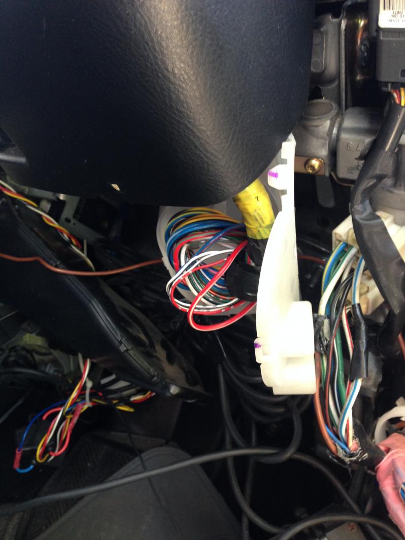

                    I wired my spotlights recently and found the reason behind all the confusion. Yes people are right when the say the the Hi-Lo beam is negative switched in the 120 i.e. pushing the stalk forward switches negative to the to High beam lamp, in the centre position negative is sent to low beam, problem is the headlight on-off switch turns positive on and off to the common terminal of the bulb. If you wire up the spotlights as a neg switched system the spotlights will come on when headlights are turned off (Neg feeds back from on off switch through bulb). If you wire them up a positive switched but use the low beam wire it will work as the only time the low beam wire goes positive is when high beam is on and the headlights are on.
                    I found this Red-white stipe wire under he steering wheel inside a white plastic tray (see photo)

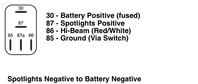

                      Old thread, but trying to clear some min-info, as it had me confused.
                      This might be true for some Prado 120, but not for mine, and the Red/White wire is actually Hi-Beam, and is positive switched.
                      I used this wire at the headlight to power the relay coil, and sent to ground via the dashboard spotlight switch.
