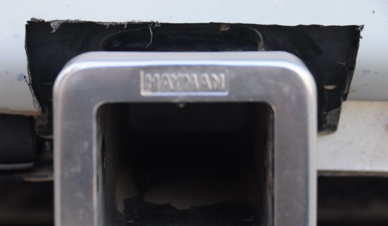

    Rear bumper cut out for tow bar. Questioned this and was told we cut plastic with a hacksaw and that's how it looks. It's not that hard to cut straight! I'll probably end up getting some rubber to tidy it up.

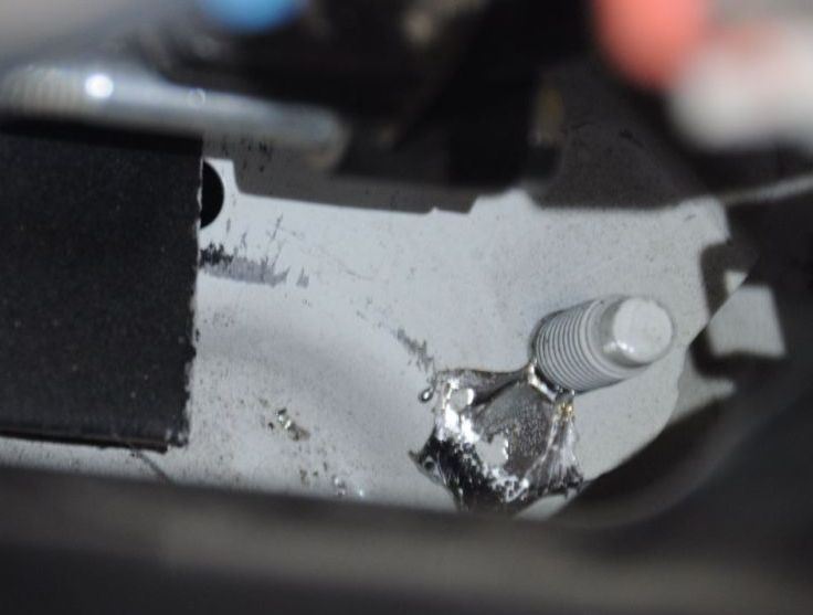

    There are a few spots in the engine bay around the compressor install where paint has been scratched and not touched up, largest is about 6cm. Mentioned this over the phone and they'll "take a look at it" when the car's back.

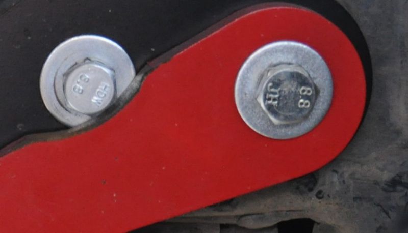

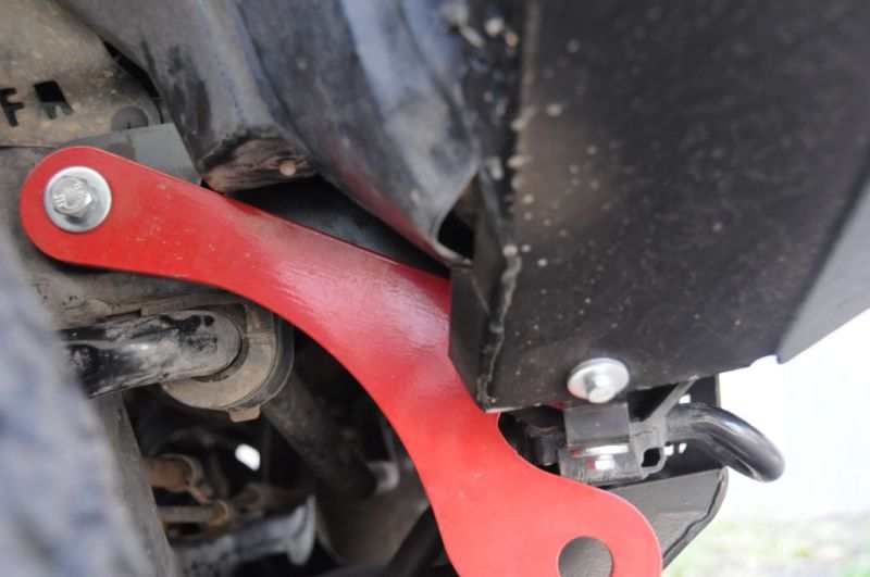

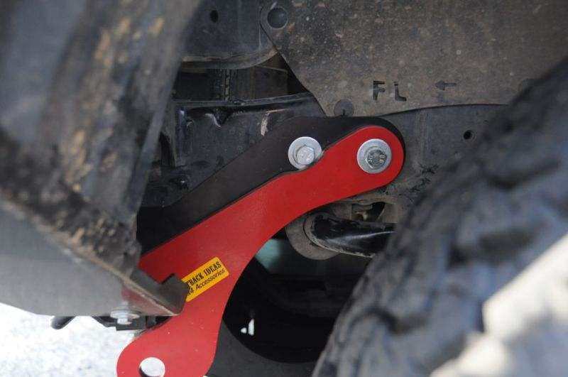

ID:	657498 Click image for larger version
ID:	657499 Click image for larger version

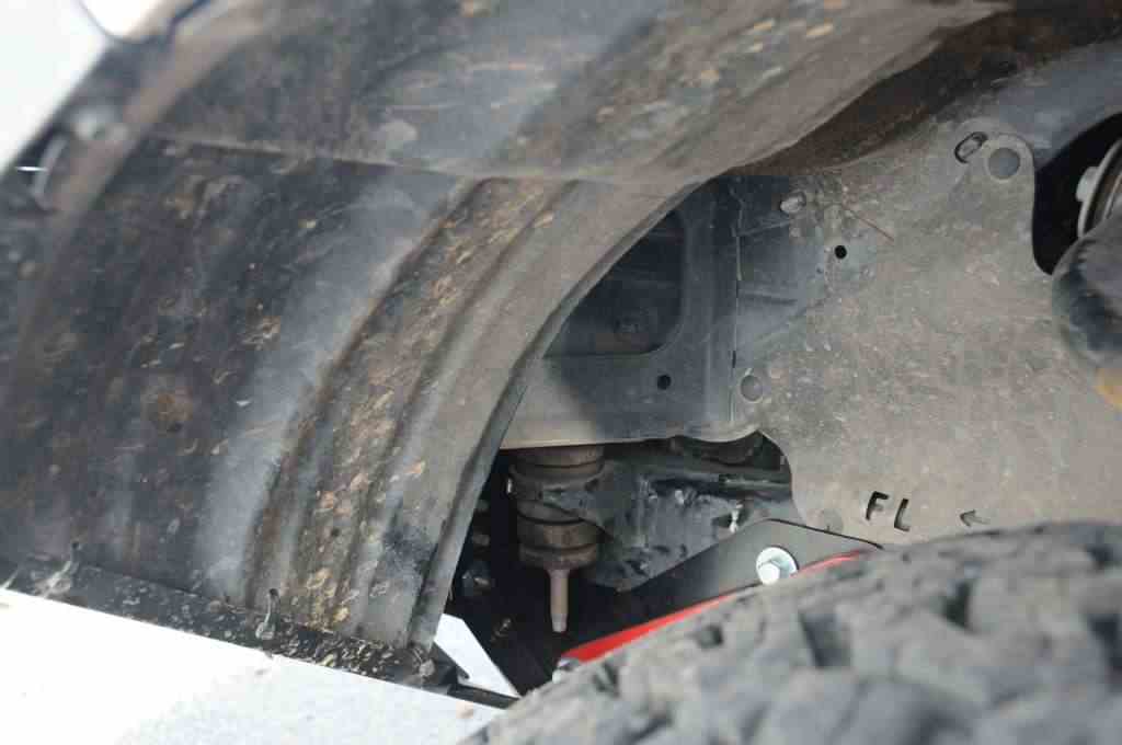

    RHS recovery point install seems okay but I'm concerned that they've ground out a section of the LHS point to put an extra bolt in for the bar. Have emailed pics to Outback Ideas for their feedback on whether this could potentially affect the strength and ultimately safety of the recovery point.

    That towabr install is the worst I have ever seen.
    I would be really pissed at paying for that.
      If I was an installer, I wouldn't be touching/modifying recovery points to fit something else that was interfering.
        I thought my towbar install was a bit rough, but it perfect compared to yours. The quality of workmanship is not acceptable.

          i agree that towbar cutting job has been hacked at! they didn't even bother smoothing it out either by the looks of things! i wouldn't be impressed. Good luck

            That's an understatement. My jaw nearly dropped when I saw that cut out...hit the floor when they said it's normal.
            My thoughts exactly. This is essentially safety gear isn't it

                      I agree with everyone else here, that cut out on the bumper is disgraceful, especially as being "professional installers" that should be an extremely easy, everyday job, I would be very unhappy with that quality of workmanship on my brand new, or even second hand car. The idea behind getting things installed by professionals is that they should do a professional job!

                        I'm a panelbeater and we regularly cut out bumpers for towbars but not like that!! And we put edge moulding on the cut edge like Toyota does to neaten things up. Thats just disgraceful. Hope you get some sort of satisfaction out of your complaints.

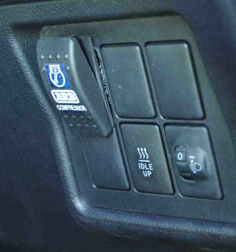

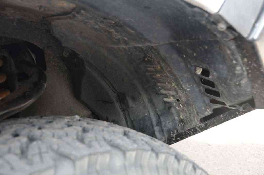

                              Since this tread has created a bit of interest, here are some more issues from the install
                              Speaks for itself
ID:	636509 Click image for larger version
                              Something's not right with that LHS wheel arch. Oh that's it, they've forgotten to put a part back on!
