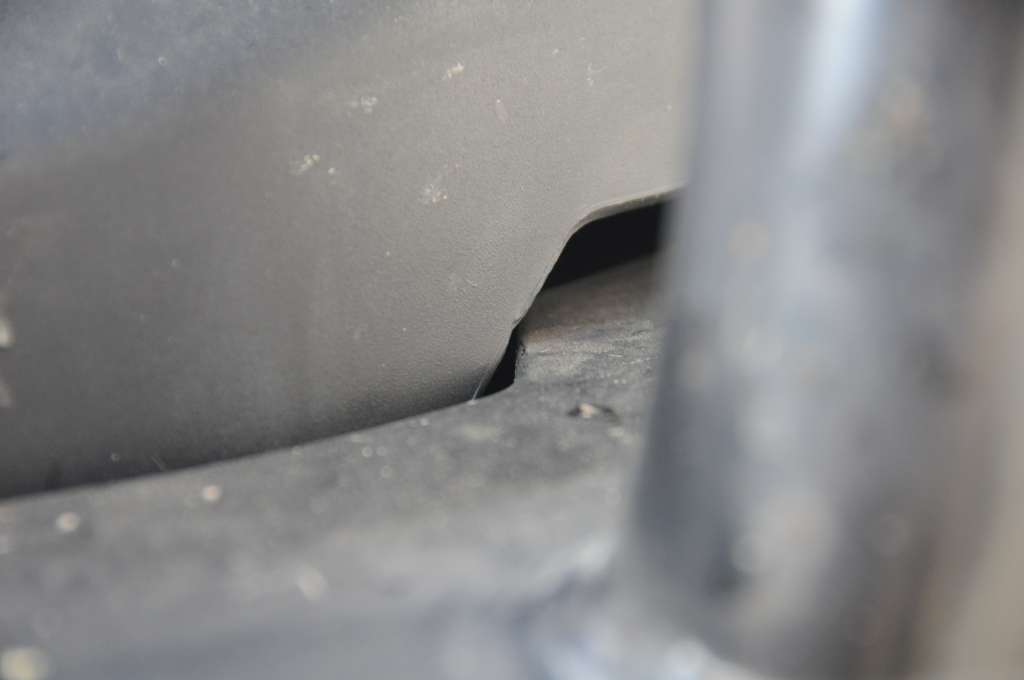

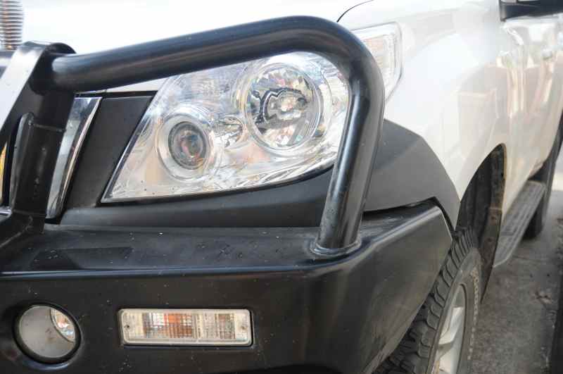

    Here's one we discussed before the install and was told that they install the TJM T13 bar with a bumper cutout, I've seen it done both ways and the bumper cut is probably neater (although now that I've seen their rear bar cut...). I questioned the black panels and was told that's how come and I can take them to get painted if I want them to match the rest of my panels. WTF!?!? Apparently because I asked for the TJM bar, I should know how it's supplied and ask for the infills to be painted. Hang on, you cut the original bumper? Nope.
    I'll be taking it to a TJM installer to confirm if the issue with the front bar rubbing on the infill panels is a problem with their product or the installation. I did get to test out the bash plate on the weekend so maybe that has something to do with the bar hitting the infills but that gap just doesn't look big enough to me.

            That gap between the bar and infil panels should be more like 15 mm. Not sure about the 150s but I know the 120s bars move a lot in relation to the body(or is it vise versa?)

              The more I look at your photos the worse it gets, I'd be really pissed off. Whats really disappointing is that this sort of "workmanship" seems to be getting more common, its like the people doing the work have a huge dose of I Don't Give A Shit.
              I agree with a lot of the other posts, you really need to stand your ground on this and get it fixed. I think you are on pretty firm ground in demanding a fix. Like I said, if they agree to fix it demand to know who will be fixing it as the last thing you want is the same person taking out their frustrations when they do the repair.

                        In the Hayman Reese bolt kit for the 150 is about 1 foot worth of pinch weld, this is to hide a cut around the bumper bar however that cut is a shocker... uses a hack saw. They might need to invest in masking tape, nikko pen and a compressor and air hack saw. Use a razor to dress the cut and then put on the pinch weld, looks a million dollars.
                        The TJM bar has also not been fitted right, first of all it is to close to the infil panels, don't worry about off road as if you cross train tracks it will rub at that gap. The zip ties on the inside inner guard are a shocker, TJM give you 3 x bolts, washers and nuts each side to better lock it on. They have also cut the drivers side to short and the same time you cross those train tracks will be about the same time that the zip ties pull through the inner guard plastic.
                        I would also be checking to make sure there are 4 bolts per side on the mount that goes from the bar to the winch mount frame on that car as I would almost bet my left nut that it will only have 3 bolts per side holding it on. Which in this case you might be lucky as you then will be able to adjust the bar down and drill the lock off holes to stop the bar moving when doing serious off road work.
