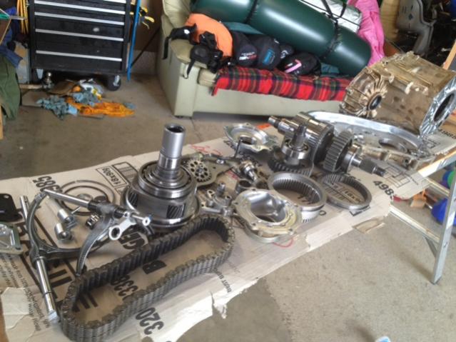

        i originally looked through the Max Ellery book which had a crappy diagram and not very clear directions on how to do it, which made me think " just get it done by a pro". After a little bit of surfing on friday night, I found the complete toyota service manual for $15 download ! Once i read the instructions , which were very clear and lots of piccy's i decided i might as well give it a go.
        For those of you that dont mind getting a bit dirty i can highly recommend the online manual i got, as it has a comprehensive guide to just about everything to do with your car.
        Phil

                    Hi Frank,
                    Here is a picture of today's progress, i have now cleaned all components ready to reassemble, got the syncro gear and the little springs in the mail yesterday just waiting on a couple of seals from toyota ( hopefully tomorrow). Then i can put it all back together.
                    Was pretty suprised when I opened the package from aust trans specialists that the part i ordered was in a "genuine toyota" package, lucky i got it from these guys as it was $40 cheaper than toyota quoted.
                      All back together and tested. Total cost $153. And a couple of six packs for favors.
                      Phil

                            Thanks for the reply barra, I have now pulled apart the case and could see that the selector fork is getting jammed , but don't really have the right tools to do such a job, so I took it down to the local bloke here in town, he reckons he'll have it done by this Arvo. Just a comment for you. The selector is in a sealed unit under the interior of the car, so if you washed it and was better , maybe you have a leak in the boot under the floor pan. I can take some photos while it's apart if ya
                            Ike so you can see what I mean
                            Phil
