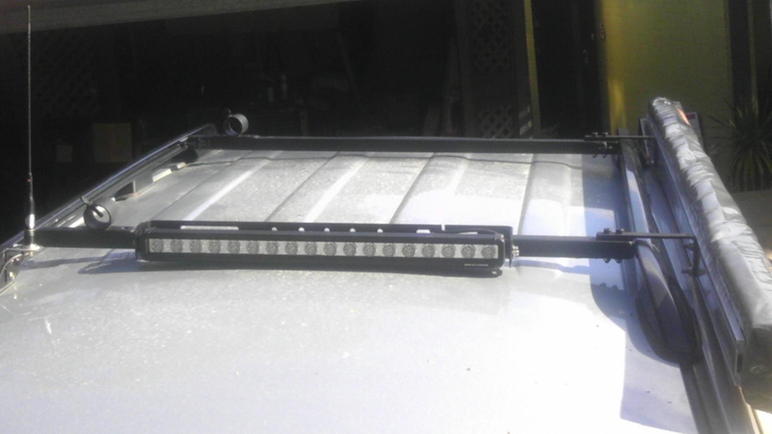

                I to have just upgraded my combo set to so spots and to HID. Couldnt wait till night fall and get out to try them. They were there 55w 6000k internal balast kit. Plug and play very easy but i must say when i turned them on and they warmed up i was very dissapointed. Having light force on other cars and the brightness from halogens to these. It seems the lenses are more short didtance spots rather than long distance as you can see the round spot on the road. Maybe i was expexting to much from the kit. Any one else dissapointed?.
                In another post i ave been fabricating a roof rack to house a Great white LED bar that i know works well. For tracks and tight areas you really cant go past a light bar.
