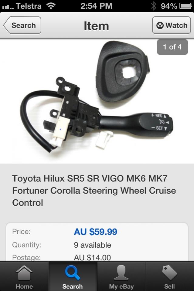

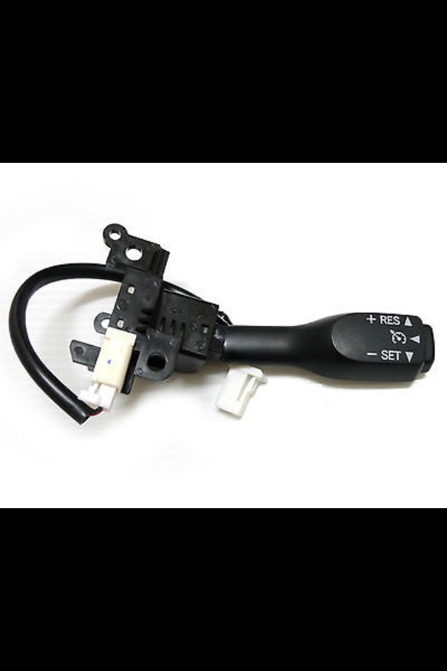

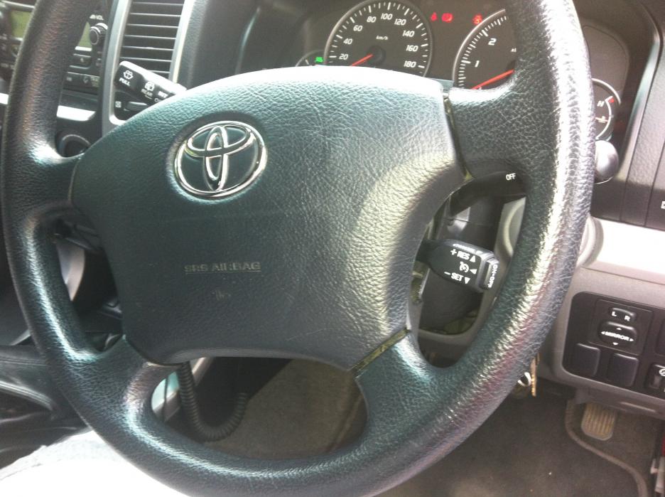

                      No OME is the way to go. Just complete the conversion today. I based it on the toyotanation tocuma forum but have had to modify along the way. It is that easy it hurts. I'll post the photos I've taken. First you need to order the stalk/switch about $50 eBay.
                      http://www.pradopoint.com/attachment...3&d=1385524895

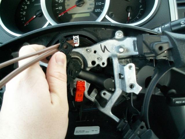

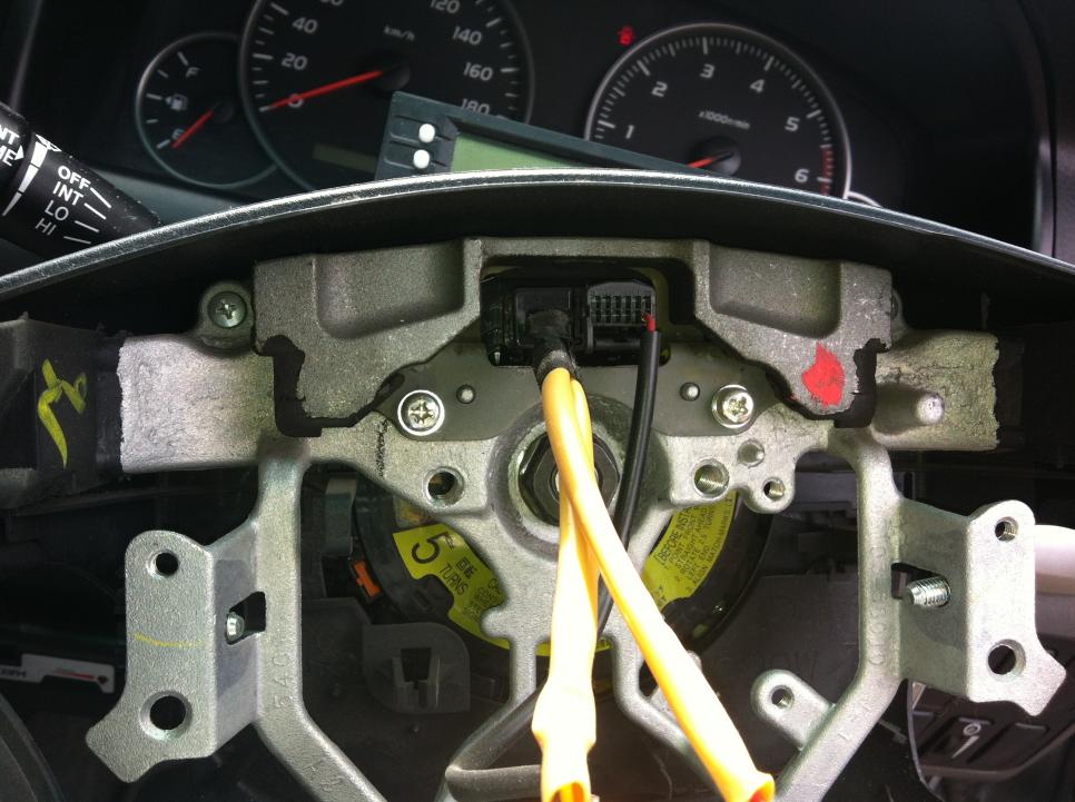

                      Remove the two panels either side of steering wheel and undo the hex bolts to remove the airbag assembly (I didn't unplug or disconnect it but be gentle)
                      http://www.pradopoint.com/attachment...8&d=1385525714
                      They are a universal fit but the plug can be different.
                      http://www.pradopoint.com/attachment...4&d=1385524949

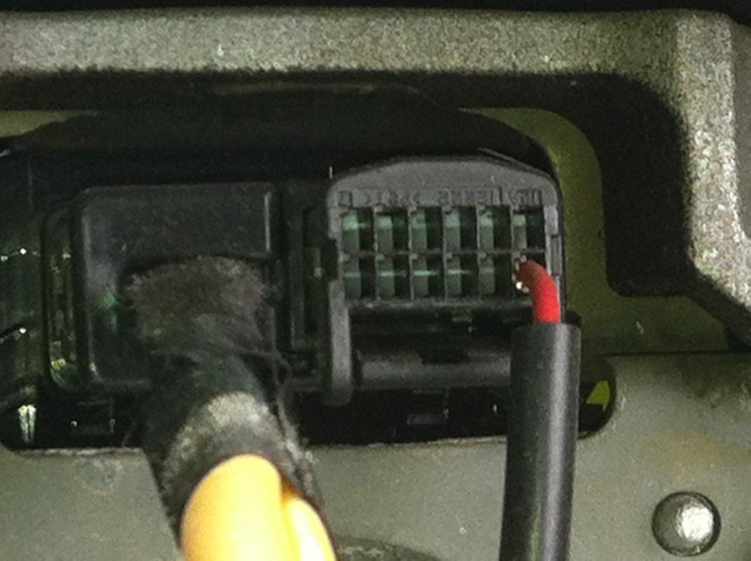

                      I was able to remove the electric contact pins (using a pin and screw driver) and place them in my original plug.

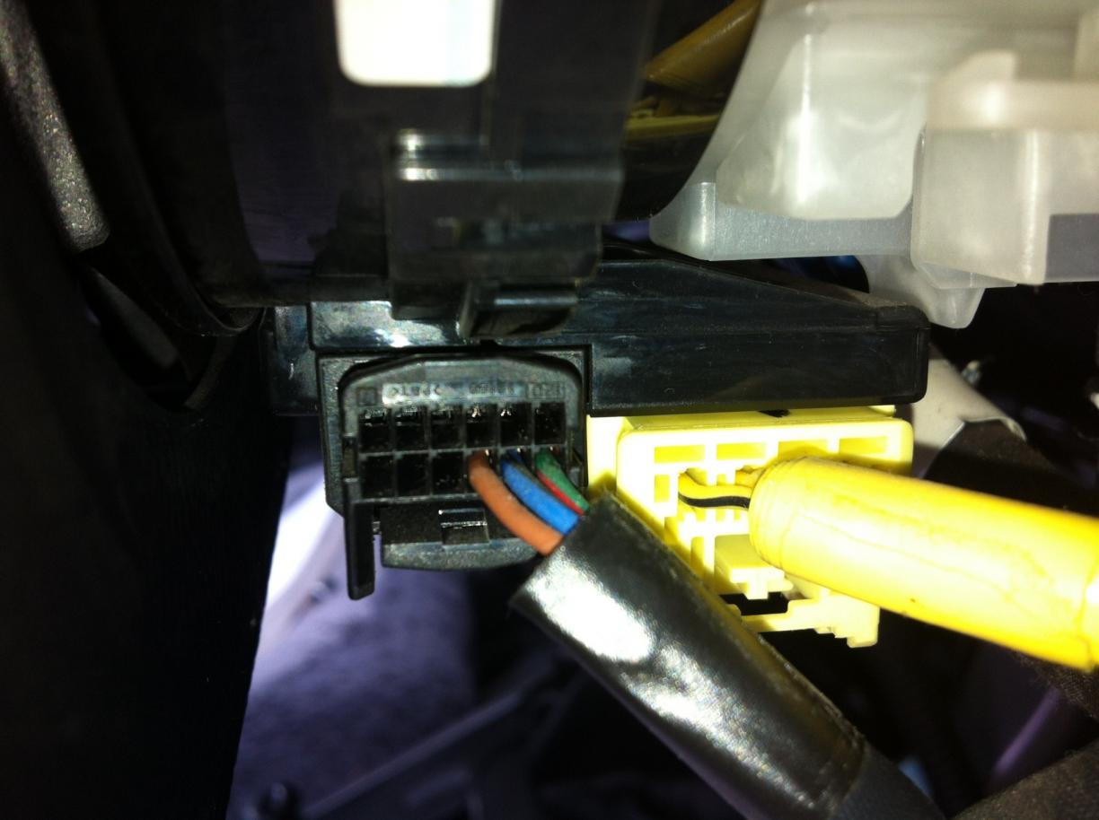

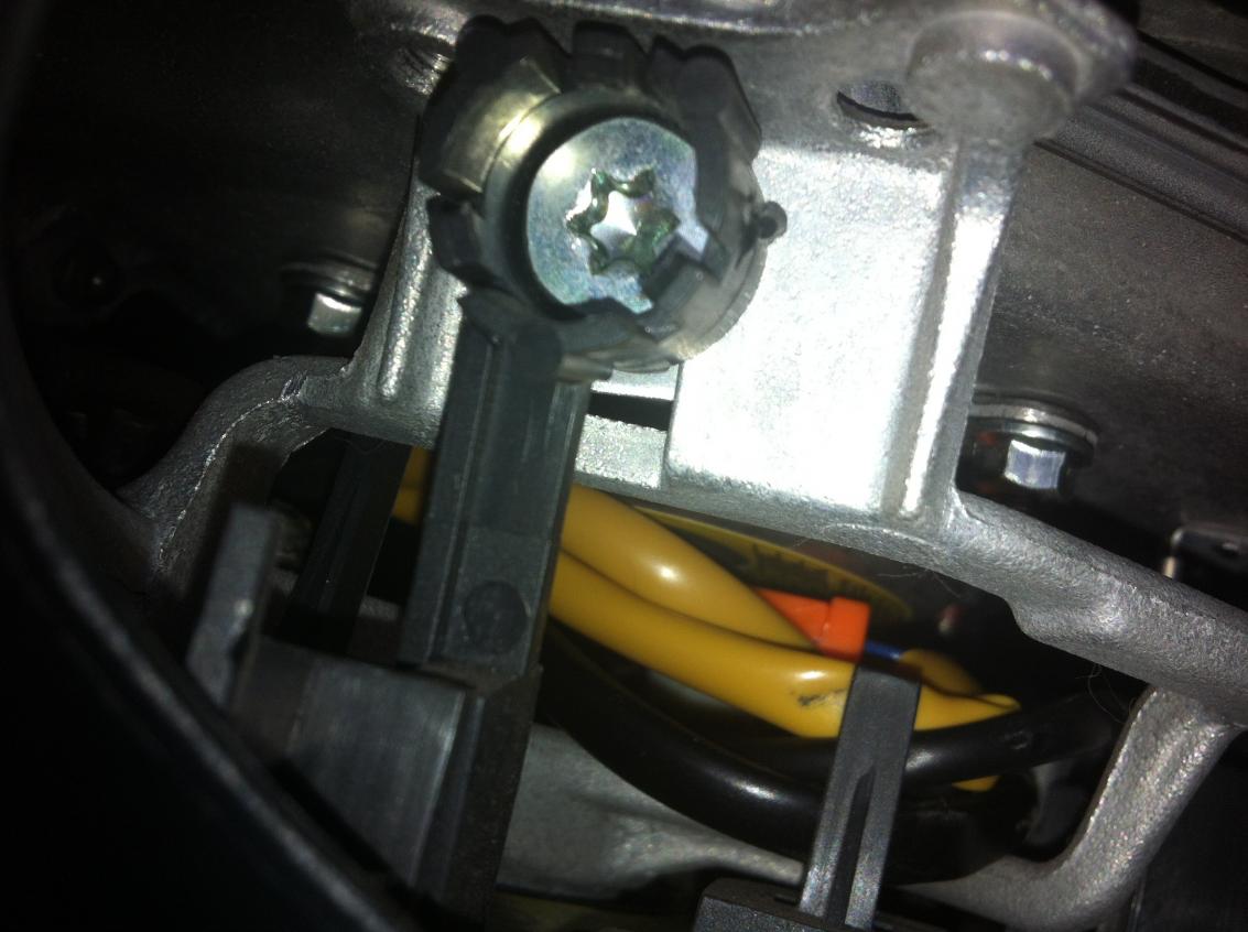

                      Steering column wires mirror steering wheel plug and provide a guide as to colour - red goes to blue/black (positive)
                      http://www.pradopoint.com/attachment...7&d=1385525095

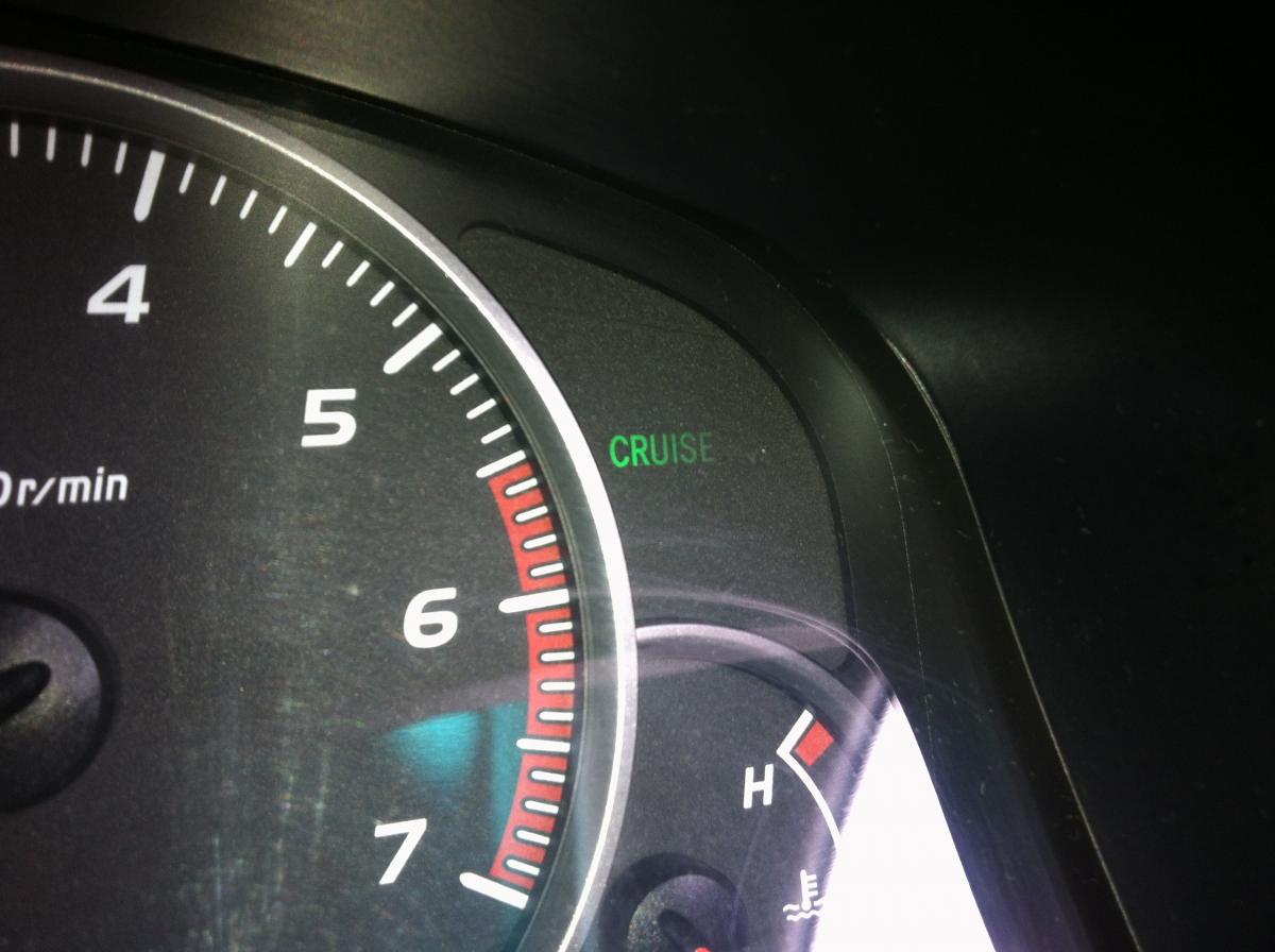

                      Connect it up and the cruise light comes on the dash.

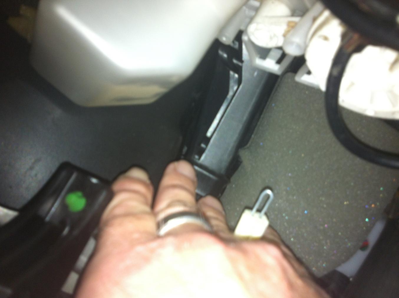

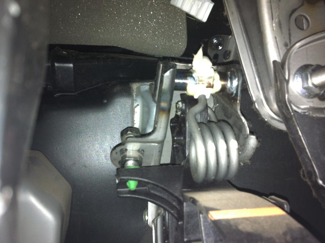

                      I have a manual so I need a clutch switch which I have ordered. It will attach and replace this bolt
                      http://www.pradopoint.com/attachment...9&d=1385525774

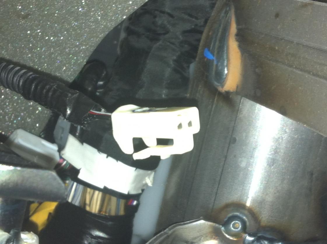

                      To see if it was working I found the clutch switch high in the dash and bridge the plug with wire. What do you know it works.
                      http://www.pradopoint.com/attachment...0&d=1385525845

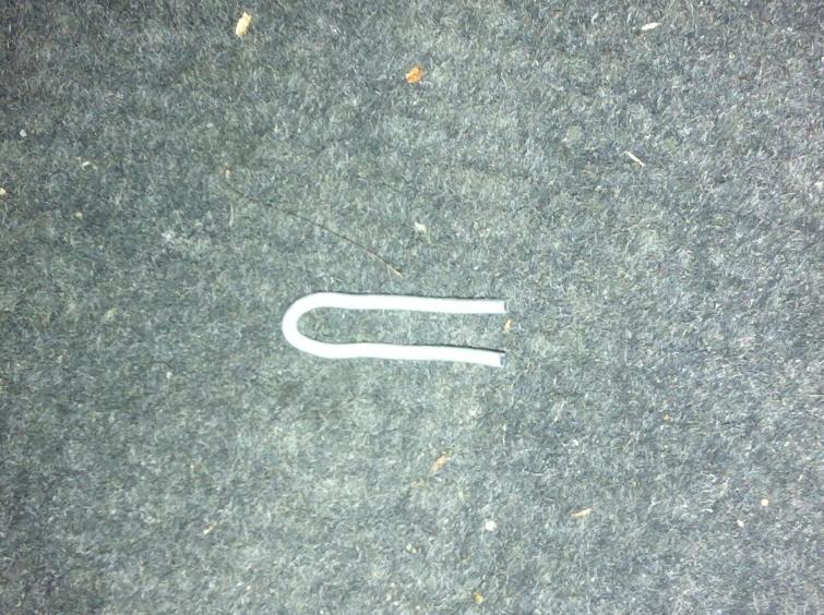

                          More images. This is the clutch switch
                          http://www.pradopoint.com/attachment...2&d=1385590710
                          and wire bridge
                          http://www.pradopoint.com/attachment...3&d=1385590810
                          I made up till the switch arrives
                          http://www.pradopoint.com/attachment...4&d=1385590901

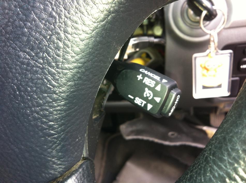

                          and the finished result.
                          http://www.pradopoint.com/attachment...5&d=1385591003
                          Really you don't need to purchase the switch wire which would save you $26 if you can put the pins from the new wire in the original plug as I did.
                          No need to add the brake switch, the original one already tells the ECU to cancel the cruise. Until the clutch switch arrives just don't change gears or the old girl revs her head off!
                          Hope this helps
