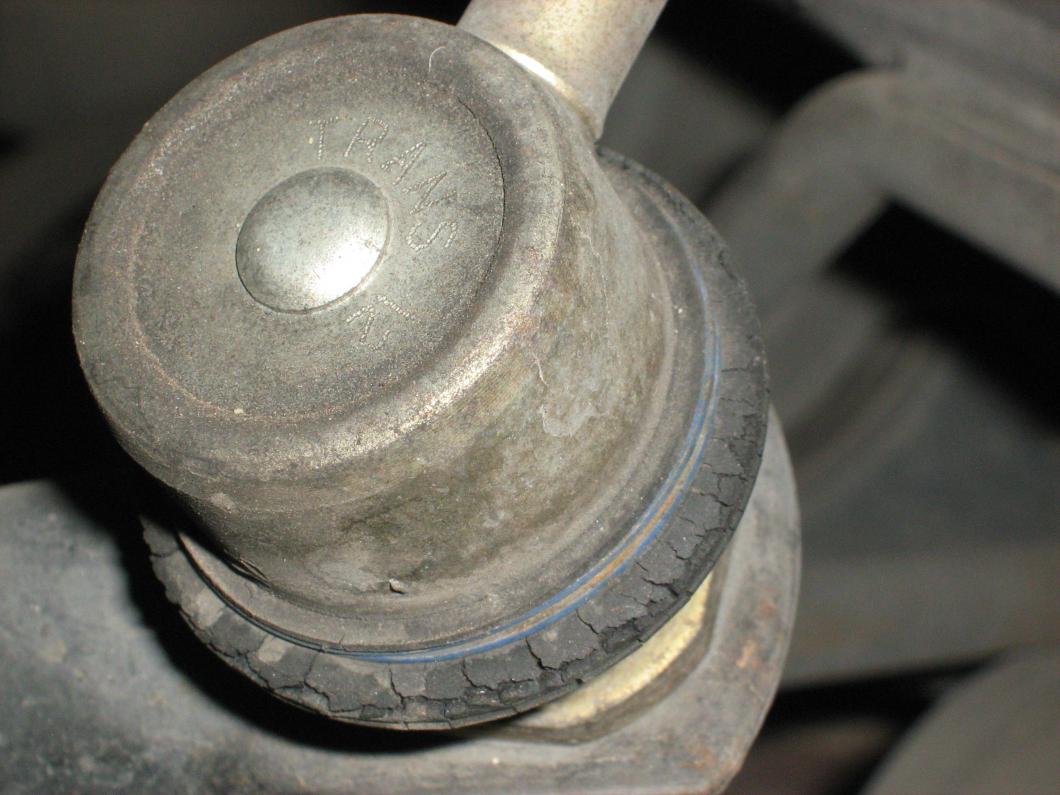

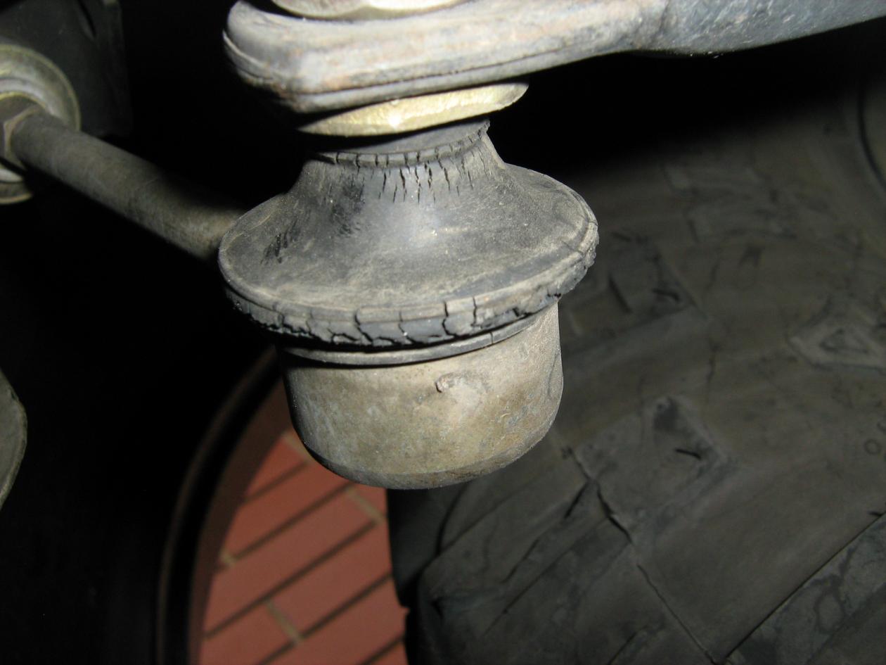

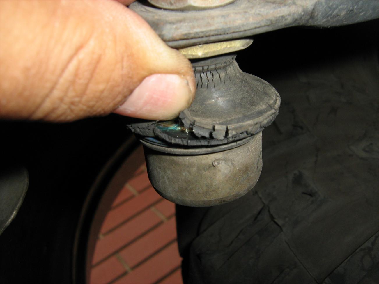

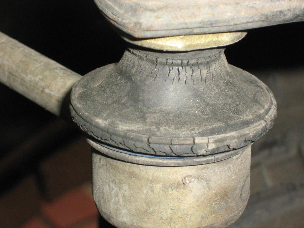

    For those of you running OEM style Ebay "Extended" sway bar links you might want to take a closer look at them if you've had them on for awhile.
    The rubber boot on the ball joint end are very poor quality. I have had mine on for 6 months and they are perished, and a friends are also the same at 7 months old.
    By perished I mean completely cracked through and allowing water and dirt in.
    The fix with out buying new ones? The original Toyota boots fit, lucky I still had mine (mind you in the bin in the shed, lucky I don't empty it often)

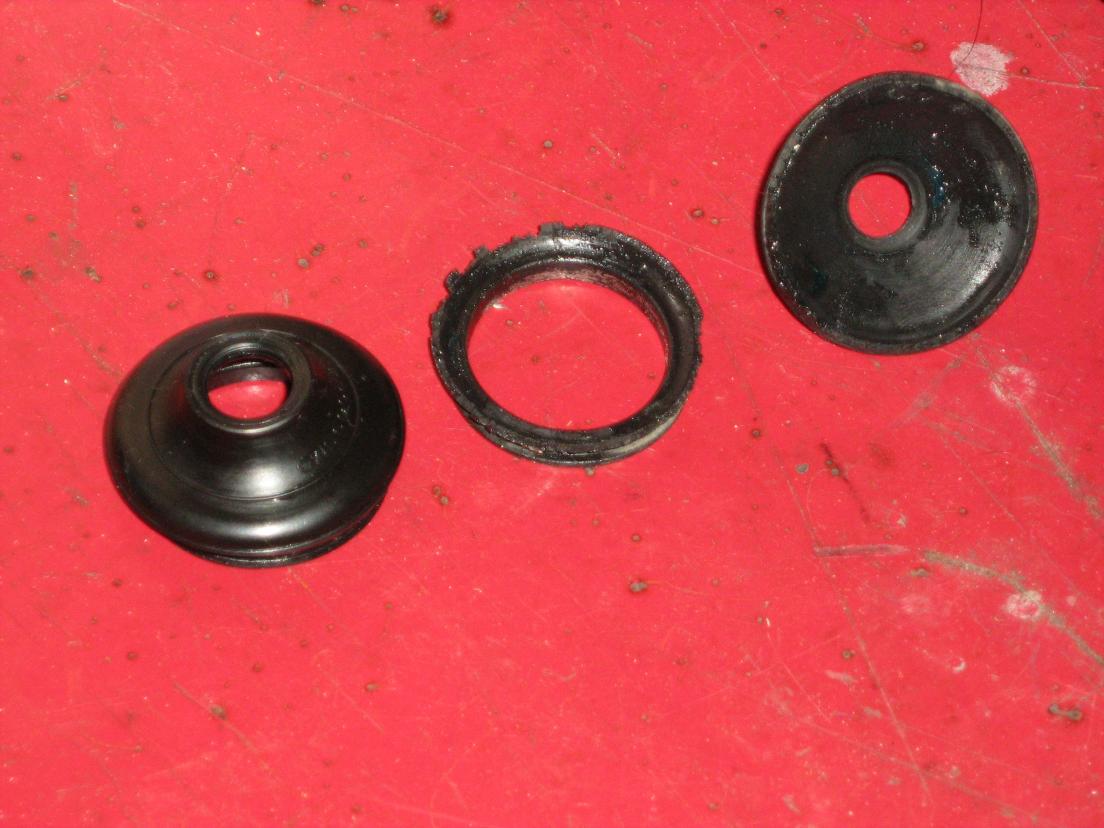

    Here you can see the Toyota one VS the aftermarket (slit in two) one. Sizes are close enough to use the Toyota boot on the extended link. Use the aftermarket ones spring clip, it's much easier to get on.
