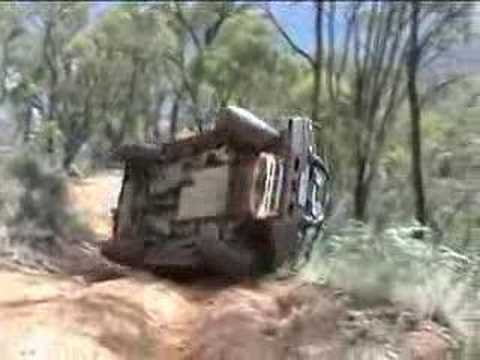

                          Very useful in this situation
                            Exactly that situation.
