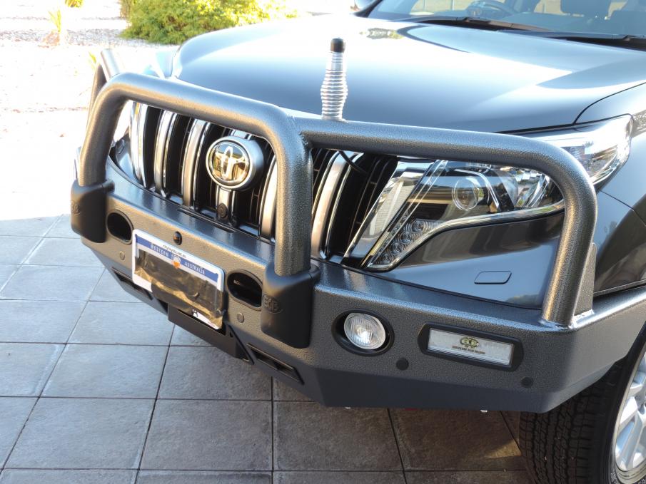

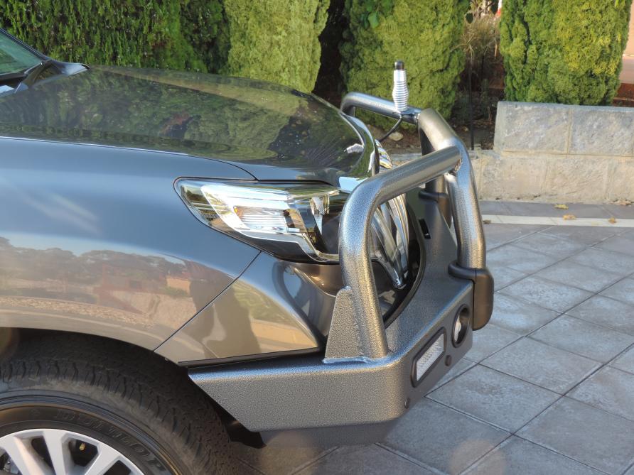

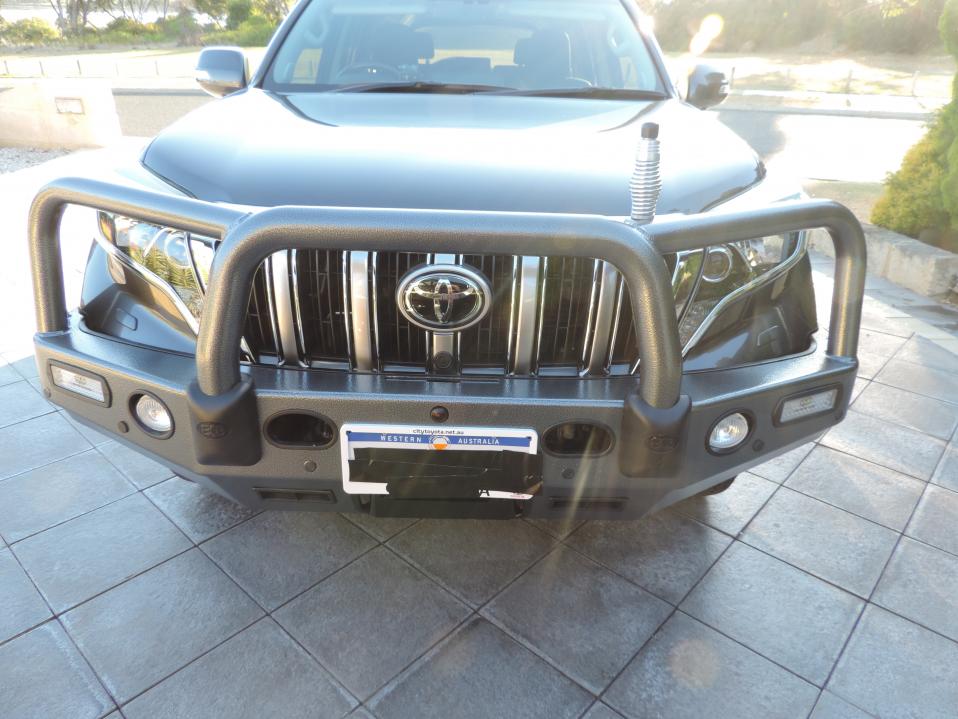

I had an alloy ECB bull bar installed (best on the market) that was winch compatible and now have a Warn Zeon installed o
=CONFIG]23993[/ATTACH]
n it. The installer did have to reposition the front camera and sensors so that the front camera and sensors would work which are important for the media camera that gives you the 360 degree view. I have a post on this site and photos showing the installation. My radar cruise still works but it is crap and I switch it off every time I engage cruise as instead of slowing you slowly, it jams on the breaks and sends you through the windscreen. Another stupid Toyota design.
